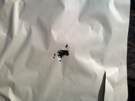

Well seems i may have been premature in assuming something was wrong with gun.  I have alot of shooting experience but not so much with wringing accuracy out of a revolver.  i guess grip method is kinda like shooting my bow, a little off on grip translates to impact very well.   guess cause of the bore line being so far from hand?
good group today with my incremental loading.  33 grains of h110 and federal 155 with 220 sierra.  i also shot some of the earlier batch and also some 180 gr xtp and all were printing similar.  I am pleased!
before today's trip i had also snugged up the cylinder gap, its below .002"  so with a runout of .001"  of front face of cylinder, i made it kiss on the tightest one.  so i guess my gap is now from .00?-.001"
i may attribute the accuracy improvement and being less finicky of ammo due to cylinder gap reduction....and my "snapping-in" for three nights before shooting again.
18 rounds in at 25yards.  some groups were better, but this is a good average.
