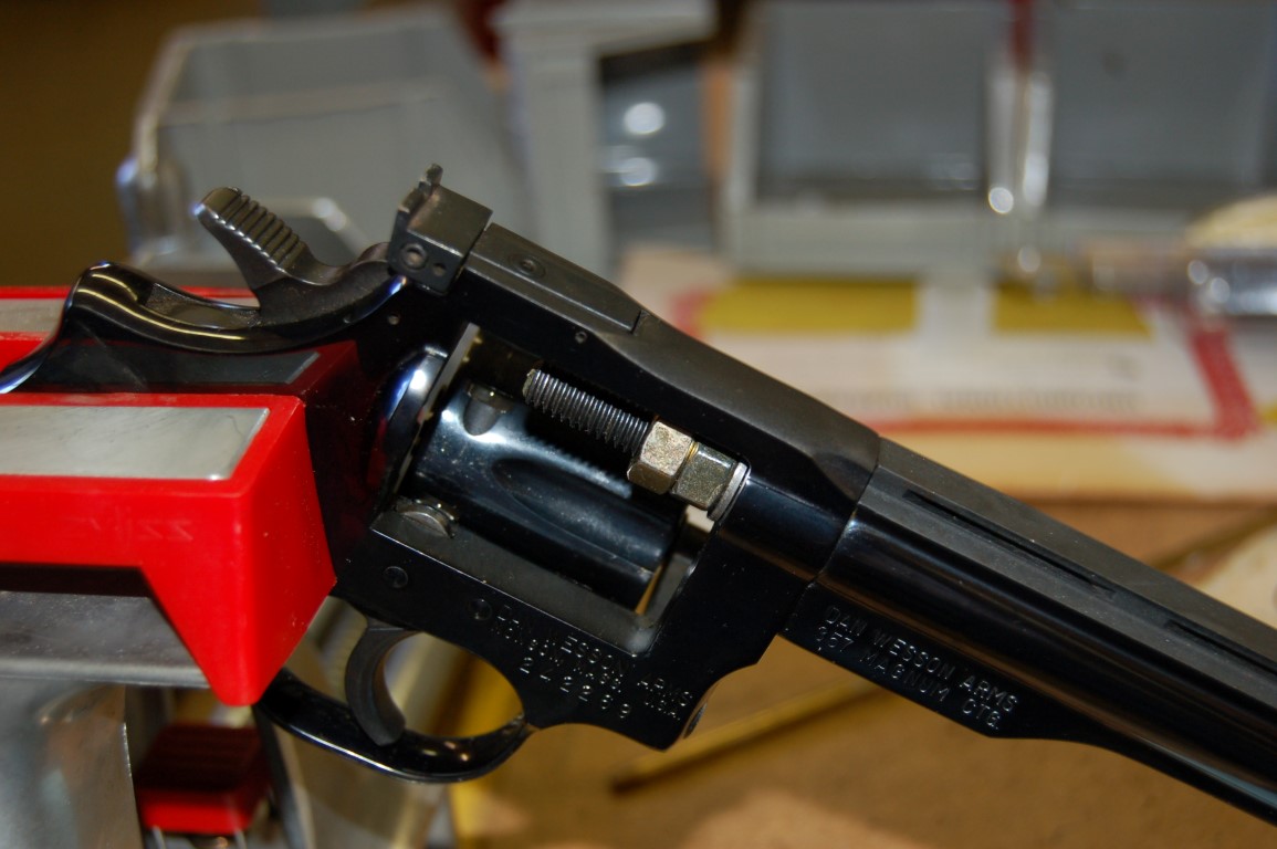

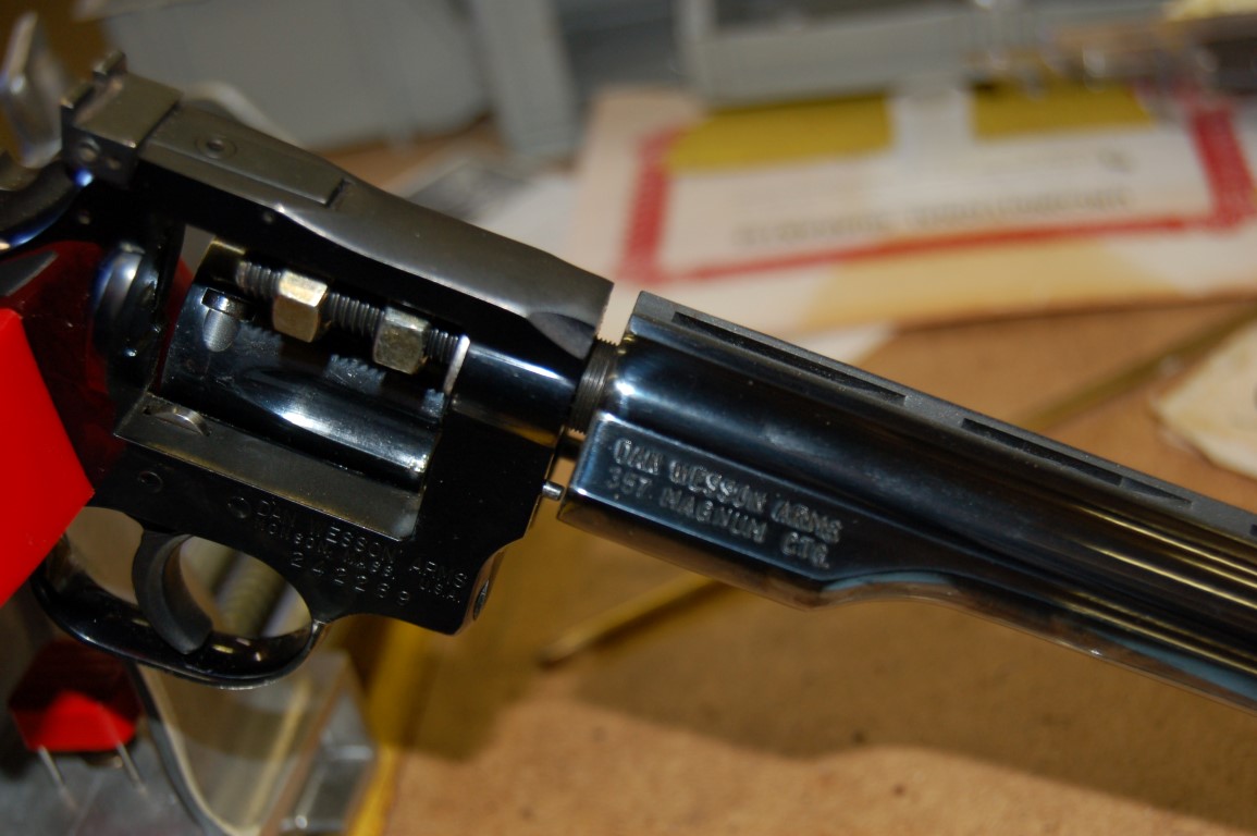

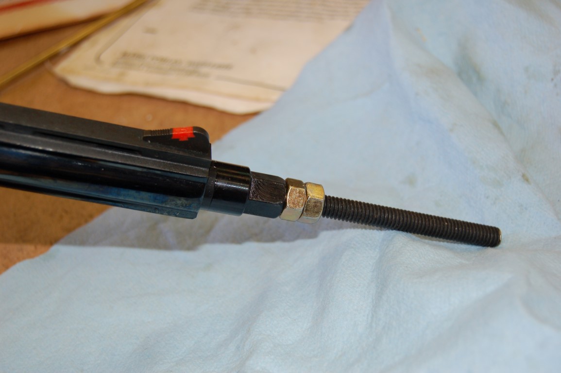

Here are pictures of ewk barrel tool in use.Image Enlarger
