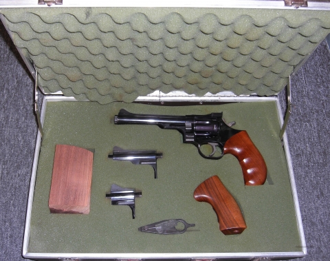

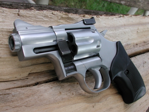

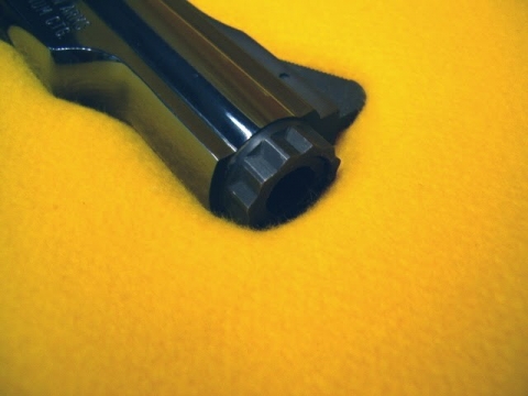

Twelve point barrel nuts did exist in earlier production Dan Wesson revolvers.  I believe the following are pics of the Model W12.

The first Dans, models 11 and 12 had the 12 sided exterior nut. The shroud wall was thicker. Within one year the interior nut debuted. Most found the exterior nut ugly. The models 14 and 15 had the same length shroud but the barrel tube was 1/4" shorter and ended flush with the shroud. Despite the shroud wall being thinner to accommodate the interior nut I have never seen the metal worn away from holster ING. Blueing yes, metal no. However, I have seen damage to the muzzle end of the shroud from mishandling. The crown is actually safe.
  There was only one 12 sided nut in the 3 barrel pistol pack of the first models. Only 10,000 were made, hence they are one of the rarest DW  items. The Wesson sons were making replacement nuts for a while. They were made on a CNC machine instead of MIM. They can occasionally be found on eBay. If you feel you must protect the barrel crown I would get a full length tube and use a 12 sided nut on the quarter inch sticking out from the shroud. Use the interior nut too.

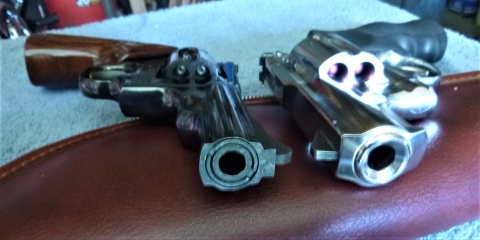

Ruger gave this Security Six plenty of chamfer in its crown.
The High Standard looks more like a straight saw cut.

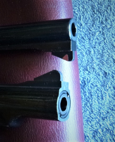

Now this Alaskan crown is more to my liking.
P1120641.JPGImage Enlarger
