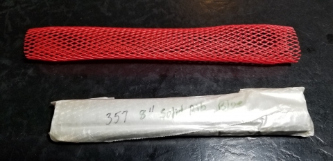

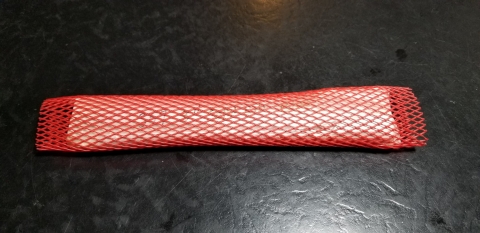

Wipe it down with an oil rag, then place it on a piece of doubled-over wax paper.  Spray it down with some Remoil, wrap it up, and mark it with a Sharpie.  Then slide it in a piece of mesh net sleeving.
