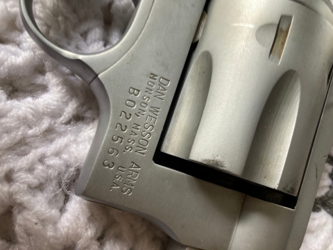

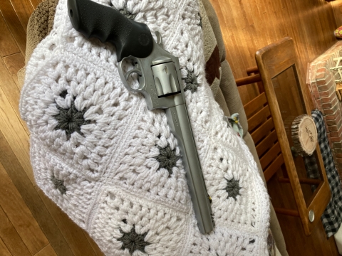

Lost , need to know what model this DW is so I can order parts!  Looking for rear sight and what ever is needed at the end of the 9+ inch barrel!  Please help me!
Forum Posts: 1275
March 8, 2023 - 6:20 pm
It is a Monson Blued Steel Model 44 with an 8" Palmer compensated barrel.    It looks Hard Chromed?
For Rear sights, look to Ruger.   Some say any of the Ruger revolver sights will work, but Ruger tells me that the GP100, Redhawk, and Blackhawk all have different sights.
For the Barrel Removal tool, EWK.
For the shroud end cap, maybe DW, but likely SOL?
March 8, 2023 - 6:43 pm
The Ruger GR100 rear sight will fit. You may need to also get a pair of Ruger springs for the rear sight. I think the Ruger sights use a smaller diameter spring than DW. Also, Williams Firesights makes one with fiber optics, get the one for Rugers.
