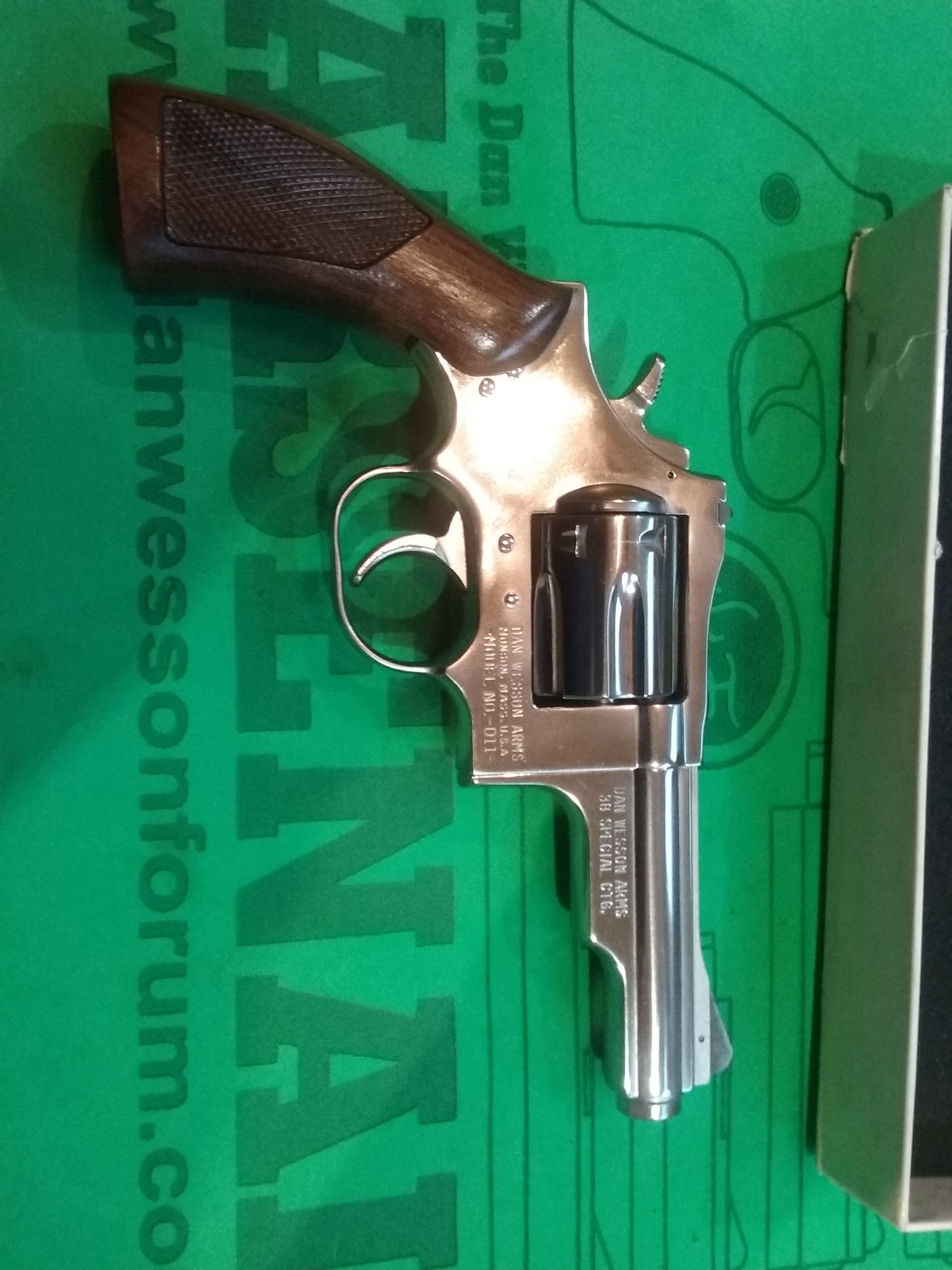

a-dan-wesson-d11-fb-3.jpgImage Enlarger
I think this is one.
