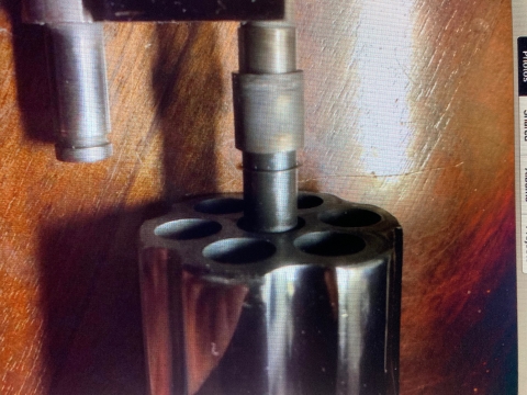

22F3B72B-BD0B-416F-83E0-62946D8814DF.jpegImage Enlarger
Better late than never so they say.
Here is a photo of an early DW cylinder showing the removable collar.
Most 15-2 owners have never seen this.

Wow; it has been quite awhile since this topic was started, but I do have an update on my early DW's. Most readers are unaware of how the earliest DW's were put together with regard to the cylinder/crane arrangement. The removable cylinder gas ring was certainly an interesting idea, but DW changed it to what we still have today around 1978. The reason? It is a much better system!! Still, there is something that can be done to correct excessive endplay on these early guns besides shims (which in my experience did not work well). I found old stock DW cylinder gas rings at Numrich. I purchased two in the hope that they might be a little longer, and indeed they were! So, I was able to fit them to my DW's, and now have a reasonable endplay tolerance. I had to thread the barrels in a little farther of course, and this proved difficult on the 15-2 (the 15-1 was fine). By turning the barrel nut onto the threads a couple of times to true the threads a bit it did eventually go in far enough. I don't know how many of these parts Numrich still have in stock, but if you're an early DW owner and have more endplay than you would like you might want to try this.

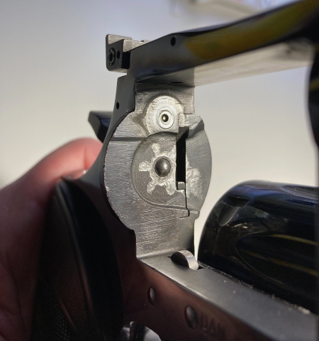

Looking back to post 52 of this topic where a .44 Magnum DW owner says he had .013 cylinder travel on his DW, I suspect that DW’s are not immune to frame stretching. My early 15-2 shows evidence of extreme cylinder hammering while my 15-1 shows much less evidence. Sure enough, when I was fitting the new cylinder gas rings, the 15-2 required a much longer cylinder collar length than the 15-1. I think I should limit my 15-2 to .38 Special loads only. I suspect that DW owners have hand loaded rounds to excessive pressures thinking that the guns can handle it, but the reality is that these loads will eventually take their toll.

Just in case you were wondering what evidence of excessive cylinder hammering looks like. This is my 15-2; it looked like this when I purchased it a few years ago and hasn’t changed as I only shoot over the counter .357s in it, and now mostly .38s.IMG_0934.jpgImage Enlarger
60
March 23, 2022 - 5:33 pm
Thanks for sharing, I did not know how to look for end shake.  Now I’m gonna check all mine out!
