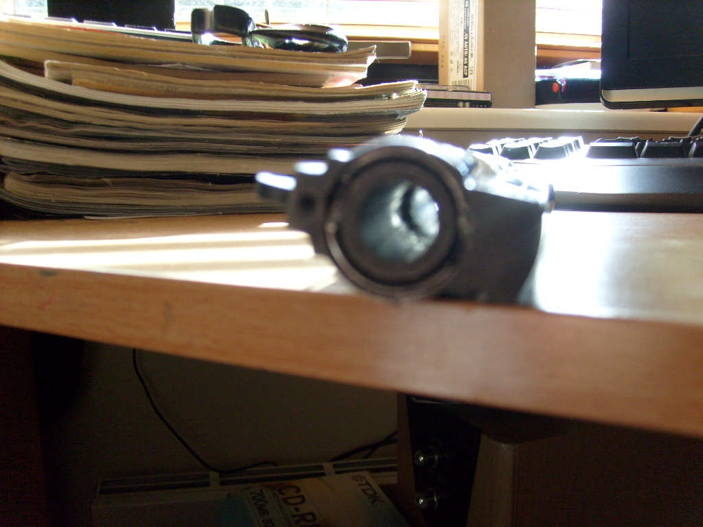

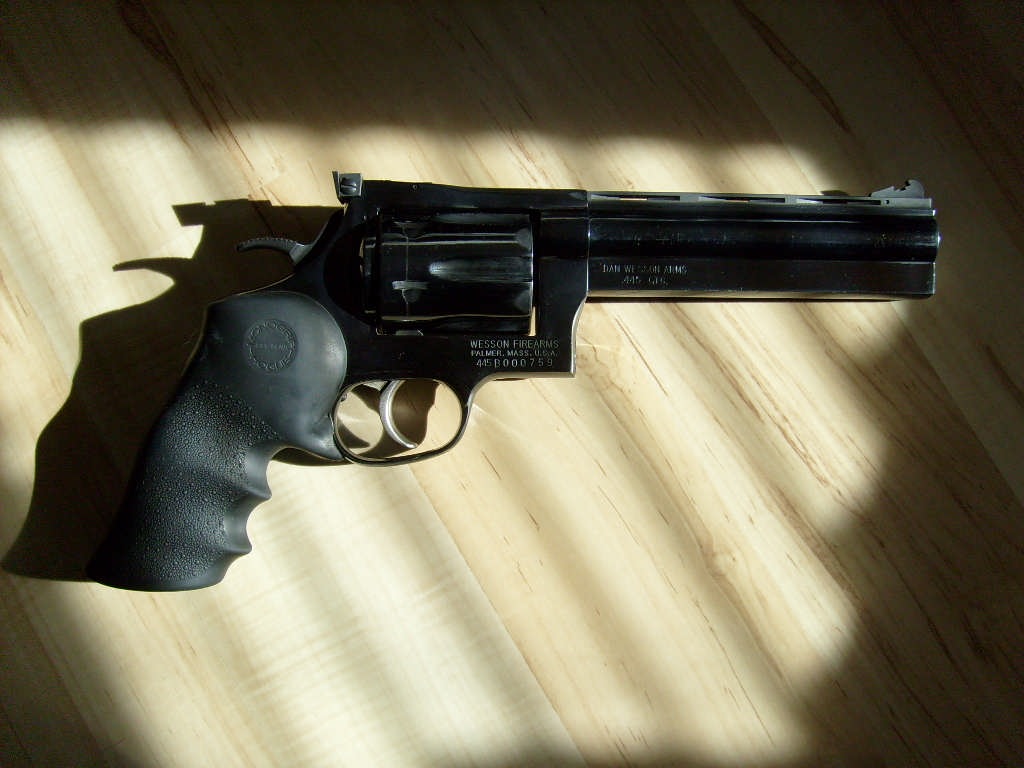

April 2, 2009 - 6:09 am
Heres a few pictures, i couldent get the bulge on the shroud to show but its there.
The barrelnut and the front end of the barrel are still stuck inside the shroud.
The 6" barrelImage Enlarger

I dont think that would have worked for me Jody as the barrel expanded and took the Shroud with it in the expansion so they are pretty much grown together if you understand what i mean.
If the nut get stuck again i will try that method though as it seems like a good way to resolve the stuck nut problem. 🙂
