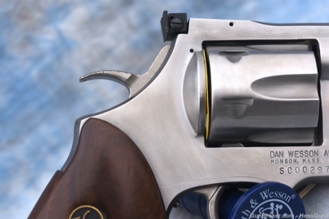

Here are the pics I promised.  First two are the stock frame out of the box, next three  are the HiViz rear sight installation I just finished using the Ruger Revolver Rear Sight, and the next is  the dressed down firing pin bushing described above. The next is the 8 inch barrel and shroud in the box, and the last is the 11degree forcing cone I cut with the rented Brownell's reamer from 4Drentals.  For anybody thinking of doing the sight installation, be advised that while the sight itself fits the frame perfectly, and the roll pin and elevation screw holes do line up, the elevation screw hole is too small.  I had to enlarge it with a 9/64 drill so that the screw would slip through it without engaging the threads until it reached  the hole in the frame where it is supposed to engage.  I also had to enlarge the two spring seating holes in the underside of the sight to 5/32  because they were originally too small to seat the springs that came with the DW sight. So, as I learned in my old motorcycle riding days, there is no such thing as a bolt on goodie. I have a HiViz Ruger front sight insert on the way, so will see if it fits in the DW slot (with only minor mods).  Hope so.  Take care all.        Mike
pix659076365.jpgImage Enlarger
pix690572210.jpgImage Enlarger
pix915054043.jpgImage Enlarger

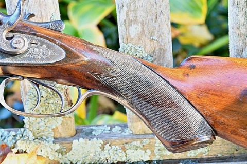

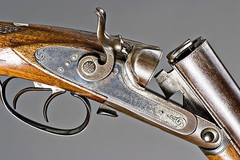

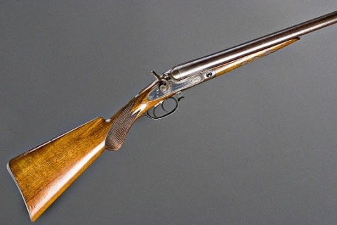

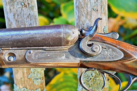

Thanks all.  Glad to know all those DW's have a good home.  Sort of like my Parker shotguns. A man's got to know his limitations!DSCF5119.jpgImage Enlarger
RSL_0259-edit.jpgImage Enlarger
RSL_0260-edit.jpgImage Enlarger
