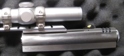

Here is a picture of one of my compensated barrels so you can see what a complete assembly looks like  Note the knurled nut on the end when that is removed there is a notched barrel nut about an inch below the knurled nut you will need a special tool (shown in the picture below) to remove that I will try and locate pictures.
IMG_2156-2-1.JPGImage Enlarger
IMG955805-3-1.jpgImage Enlarger

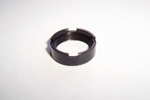

This nut below is the barrel nut below the knurled nut.
BARREL-NUT.jpgImage Enlarger
