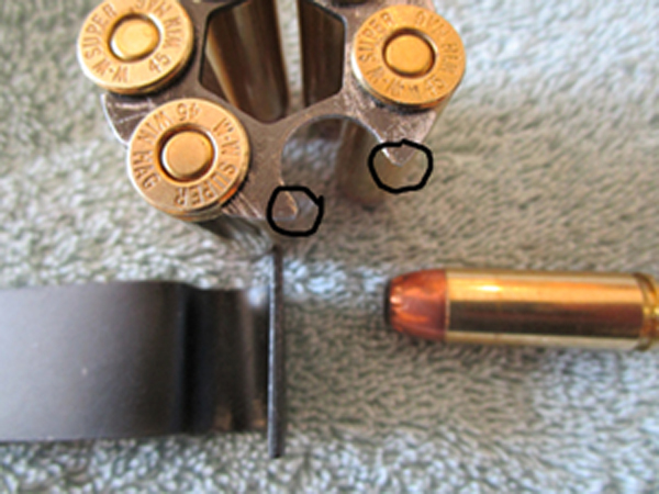

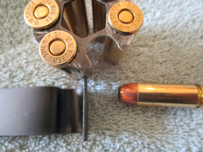

Here's what I did to make the Winchester ammo fit the moon clips, I used a small Swiss file and was real careful not to remove too much material from clip.
They are still hard to install but not too loose, tool show with moon clip makes removing used brass easy.

Thanks very much to one and all for your replies.  As always, this forum is first class and a treasure chest of information.  I will try the file trick and see how it comes out.  Willy, did you file the inside of the hole to make it larger, or did you just file a bevel on the two "points" at the opening to make the opening larger?  Do you think a Dremel tool would be too aggressive?

I filed in the area circled. Be careful not to take too much off. 0064.jpgImage Enlarger
