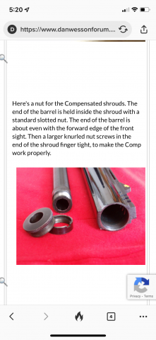

E5697951-4C41-47BA-BC6E-79376FE6AE04.pngImage Enlarger
 Looking for DW knowledge & wisdom, does a 7445 Super Mag that is compensated require a different/specific barrel tool?  It looks like the barrel nut is the same as non-compensated, but the barrel nut appears to be deeper within the shroud.  It seems like a special tool is needed to reach deeper within the shroud.  Any help appreciated!  See pic for example I got from an older thread on this site.
December 4, 2021 - 2:03 am
Yes, there is a Dan Wesson factory tool for a compensated barrel. It fits inside and tightens the nut. DW factory should sell them or eBay sometimes has one for sale.
December 4, 2021 - 2:11 am
Thank you for sharing your knowledge, much appreciated!!!
