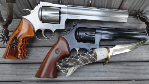

DW did make a 45 long Colt as well as the 460 Rowland, both not super common.
Forum Posts: 5437
December 6, 2018 - 5:31 am
They look like:
DSC01233.JPGImage Enlarger
Got as close to duplicate SN#s as I could...

Damn that is cool! That’s got to be quite rare. Had no idea they made them in 45LC.

That is why I made the suggestion .. they got the skills and the parts. Spare Parts may even have a correctly etched shroud. Would be a cool upgrade.
Would be cool but I have no desire to get into 45LC. Money is super tight as well.
