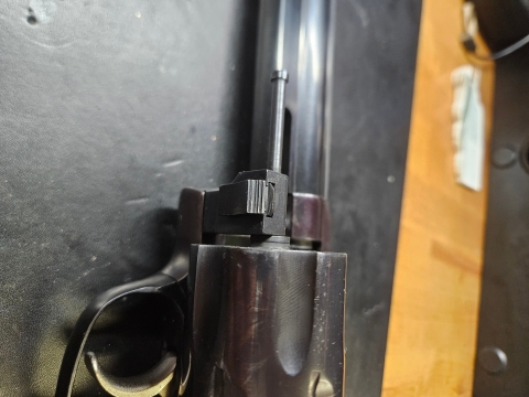

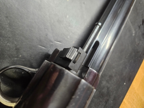

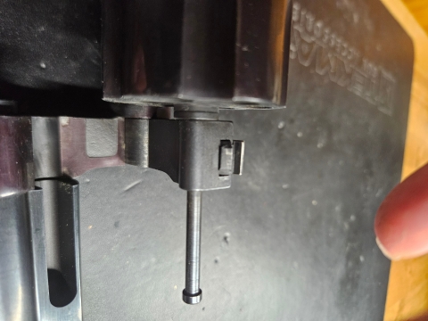

Forum Posts: 1275
February 24, 2026 - 1:08 pm
I think Ron may be saying the crud/old dried oil can be down inside the latch not letting it rise up enough to get good purchase on the notch.
The latch doesn't need to be rounded as it should catch along the entire edge of the notch if it travels to it's full extended height our of the crane.

Ron is right about the shape of the latch being a trapezoid. Have you checked the latch spring? You will have to remove the latch from the crane to check the spring and the channel that the latch runs in.

Thanks guys… I will take apart again and re-clean. It’s good to know that the notch is rounded on others. I may just purchase a new latch if I am not seeing any build up in the spring area of the latch. Hopefully I will get this straightened out… thanks for the quick replies and the photos everyone.
