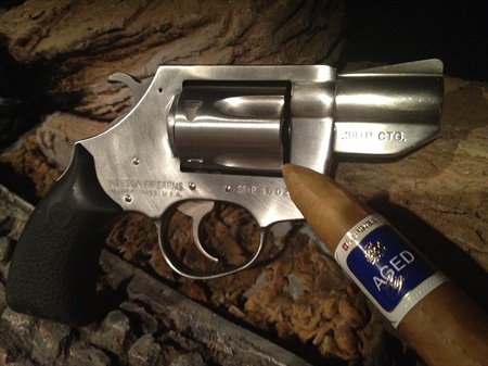

Looks like a Lil Dan, I'd say depending on conduction, box, and paper work 600 to 800 range. Offer less, or try to get them to come down. Good luck.

Looks like it's just the gun, no box or wrench.
January 19, 2015 - 10:48 am
Lil' Dan, a fairly uncommon DW item. No need for a wrench, it's not an interchangeable barrel.
For a collector or hardcore DW revolver guy, $600 would probably be right. Play dumb and see how low you can go, it's a sort of specialized item
January 19, 2015 - 10:51 am
The barrel is removable but I don't think any other lengths were available.  EWK sells the wrenches if you need one.  It's nice to be able to remove it for cleaning but not necessary.  These guns also have unique lock work from the other Dan's.  $600 is about right for just the gun.

Got the gun.  Very nice feel to it.  The lock up is Python tight. I'll clean it up and post pics later.
