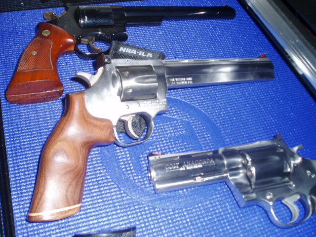

Finding washers for this Hogue grip is not an easy thing. The machine screw furnished with grip has a very small shoulder, I'm uncertain as to Hogue's reasoning behind this. Nonetheless, I bought a handful of #8-32 lock washers and nipped them, then squeezed them onto the screw such that they reduced the effective length of the threaded shaft without changing the diameter of the shoulder. The result is a perfectly tightened, unmolested grip.
Here's a picture of my 715 with it's drawer mates, a sultry crowd if there ever was one.
From left to right, S&W 29-2, DW-715, Colt-Anaconda.

That's a good looking group.drool  Glad you were able to get the grip screw handled.

November 11, 2011 - 2:29 pm
drool  That is a good-looking trio.  How dare you show me that Colt.  laugh  I'm in enough trouble with me DWAS. wife

November 13, 2011 - 10:17 am
Ah yes, that Anaconda. I traded a Smith 625-3 (.45 ACP) revolver straight across for it; one of the most painful trades I've ever done, no regrets now though.
