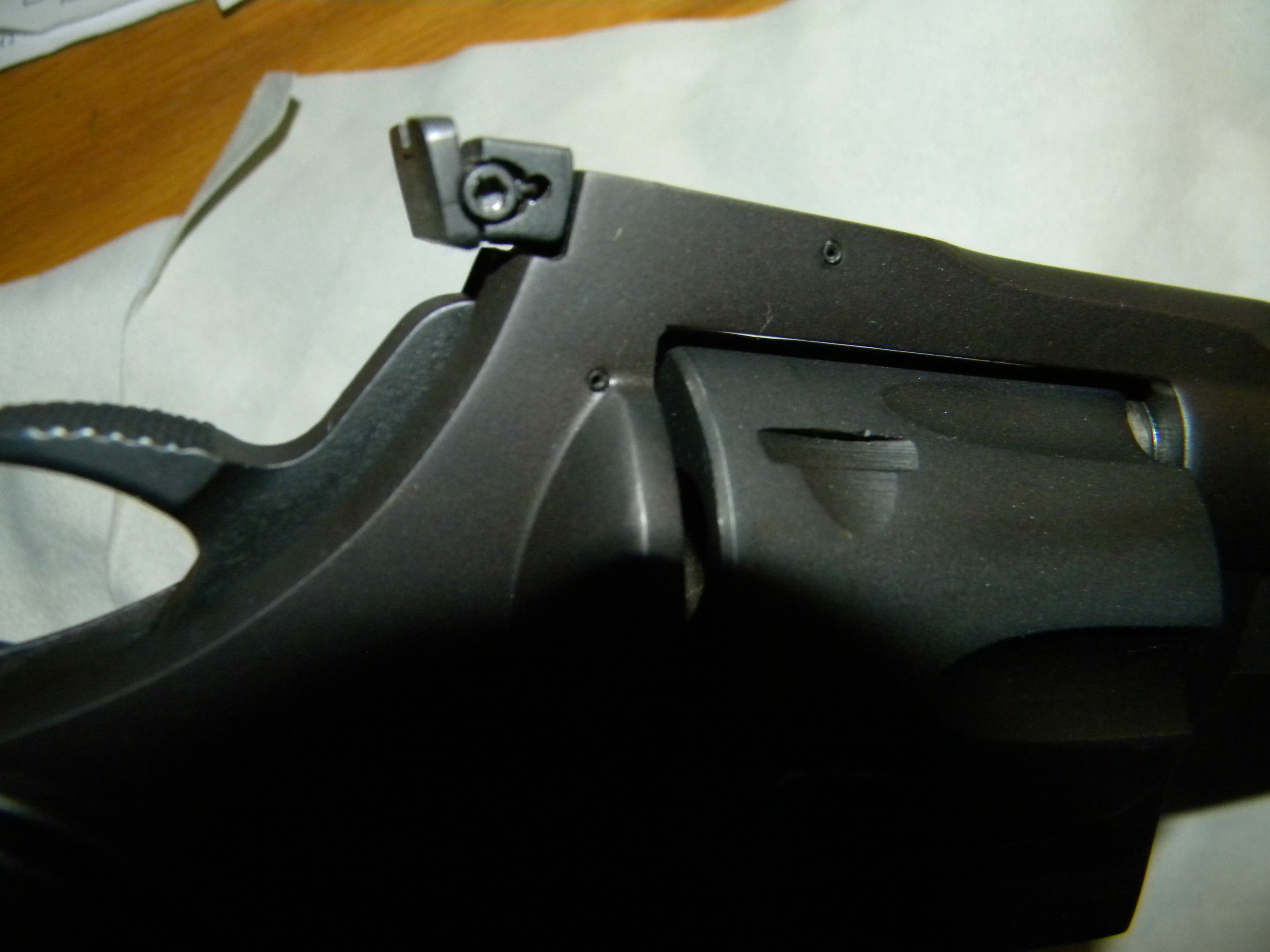

I am also looking for a replacement rear sight assembly. All the ones I see do not match mine. Any ideas where one can be had ?.

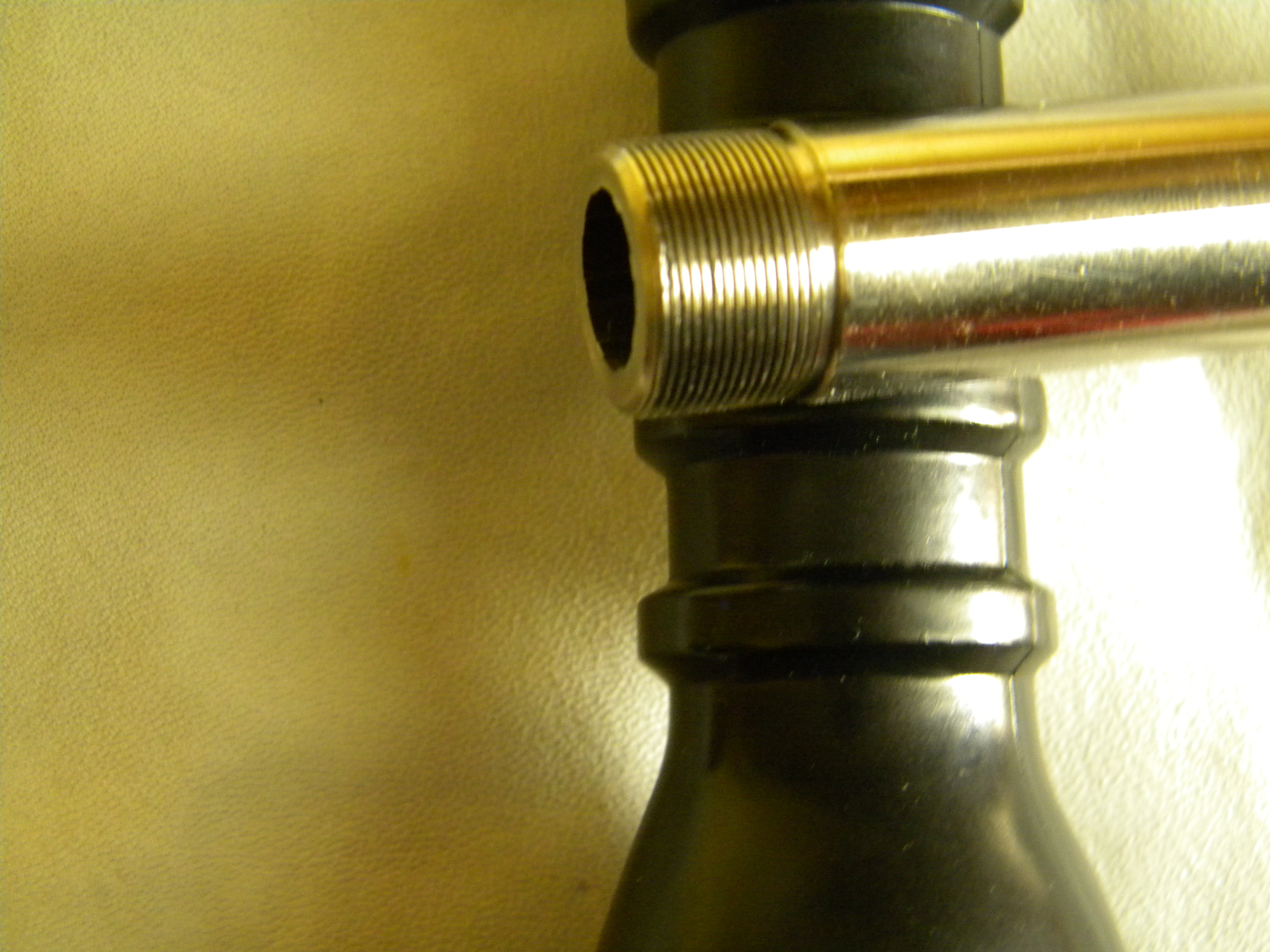

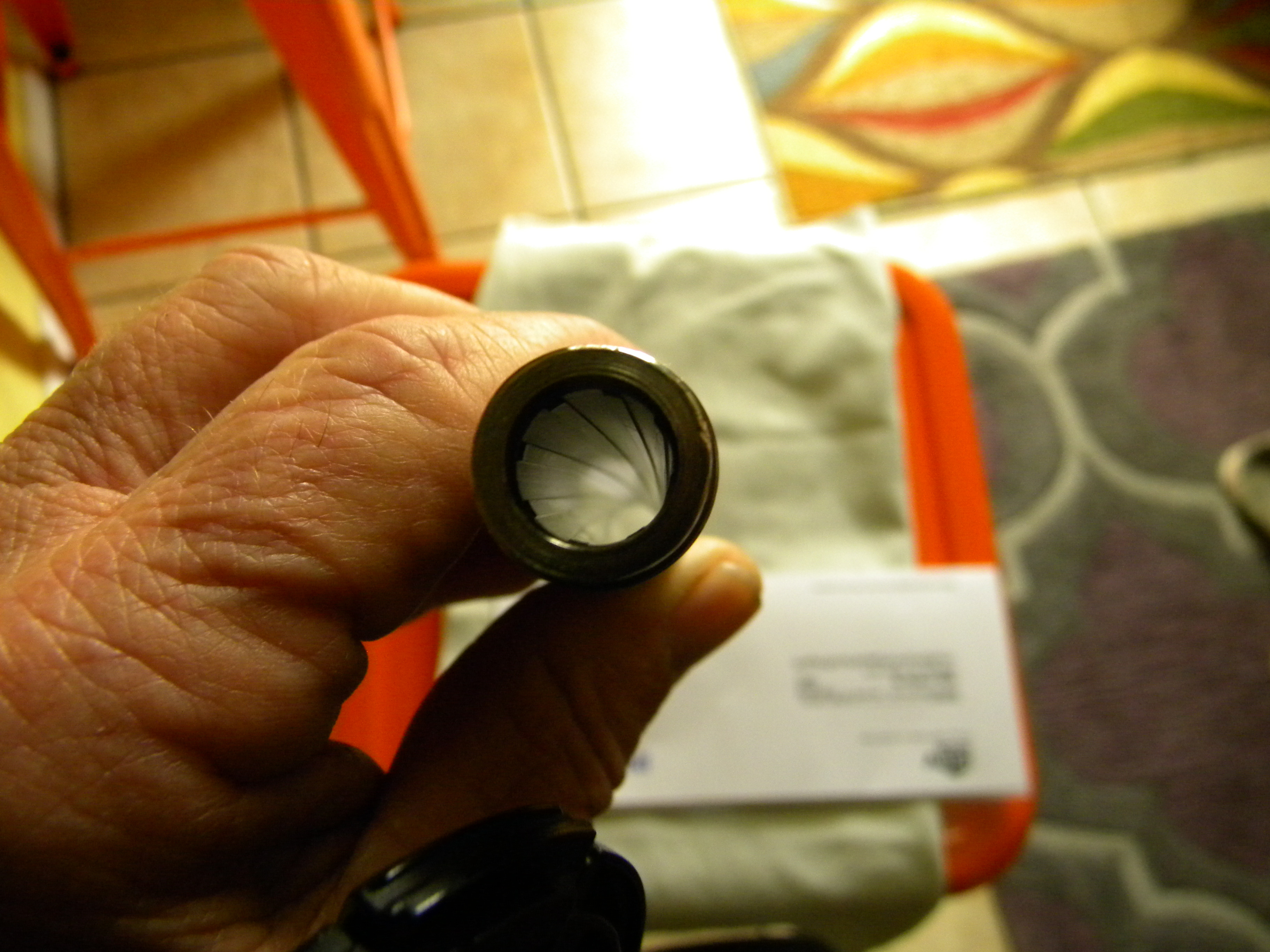

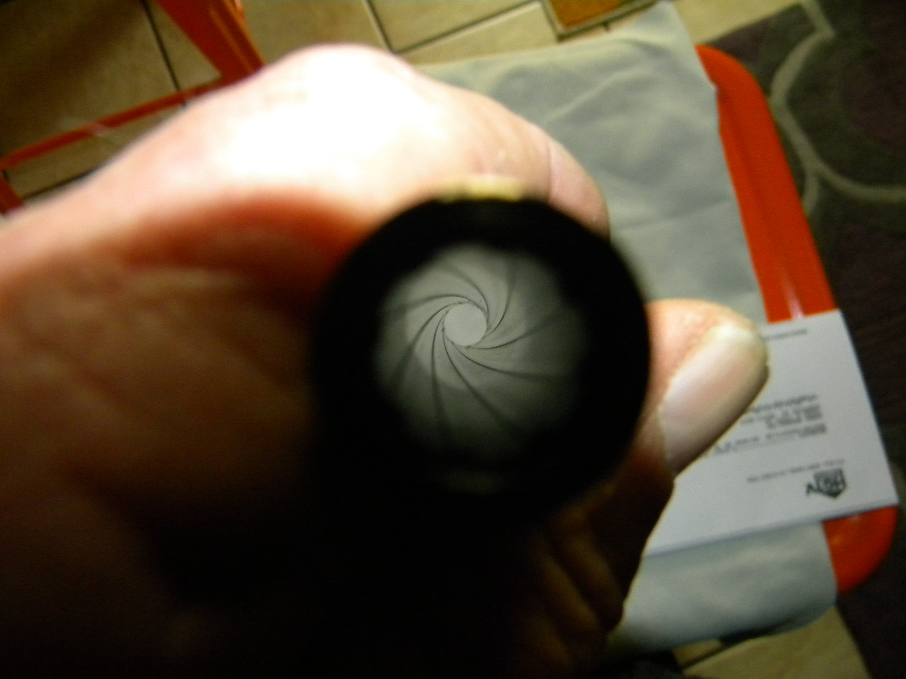

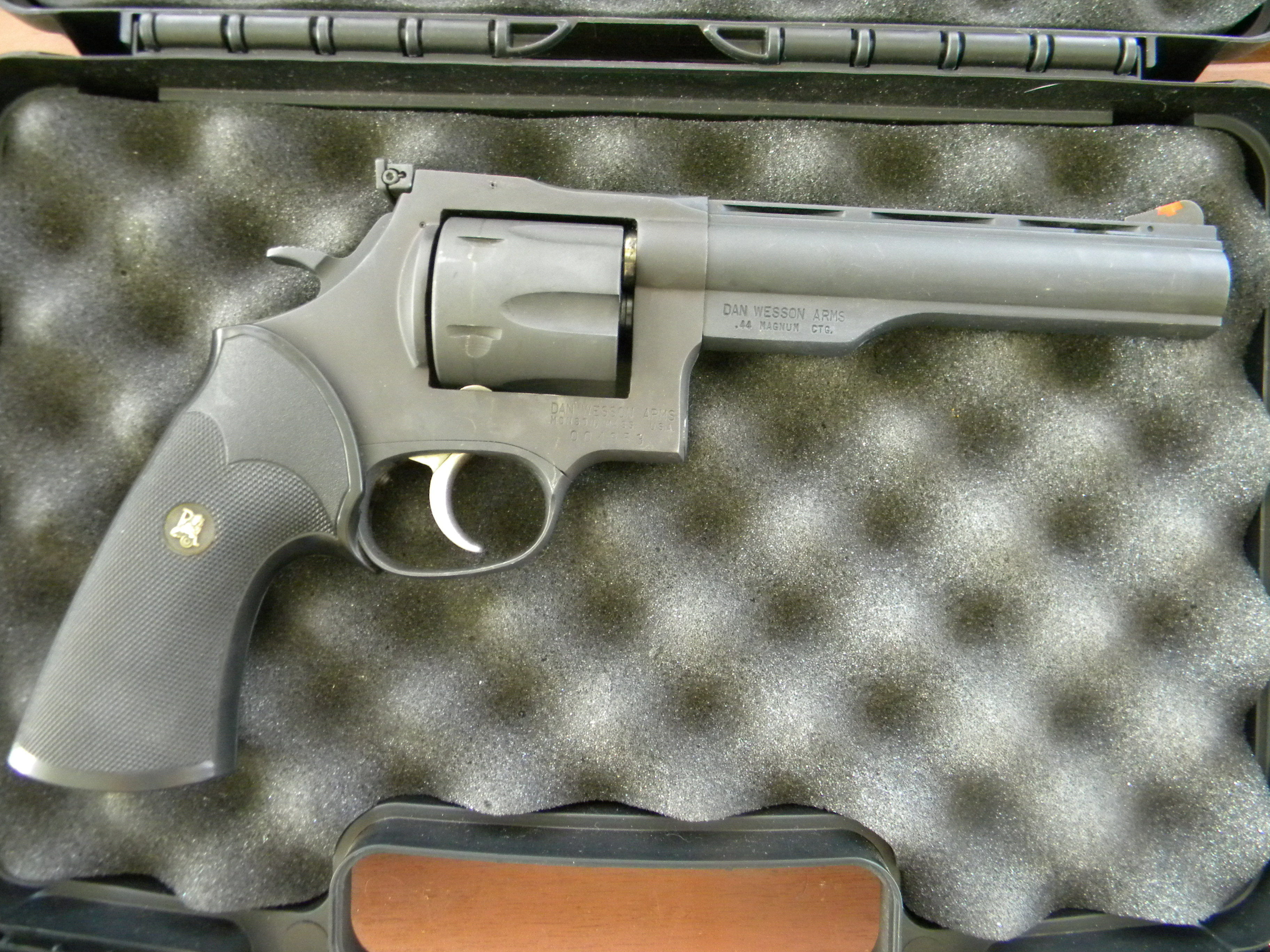

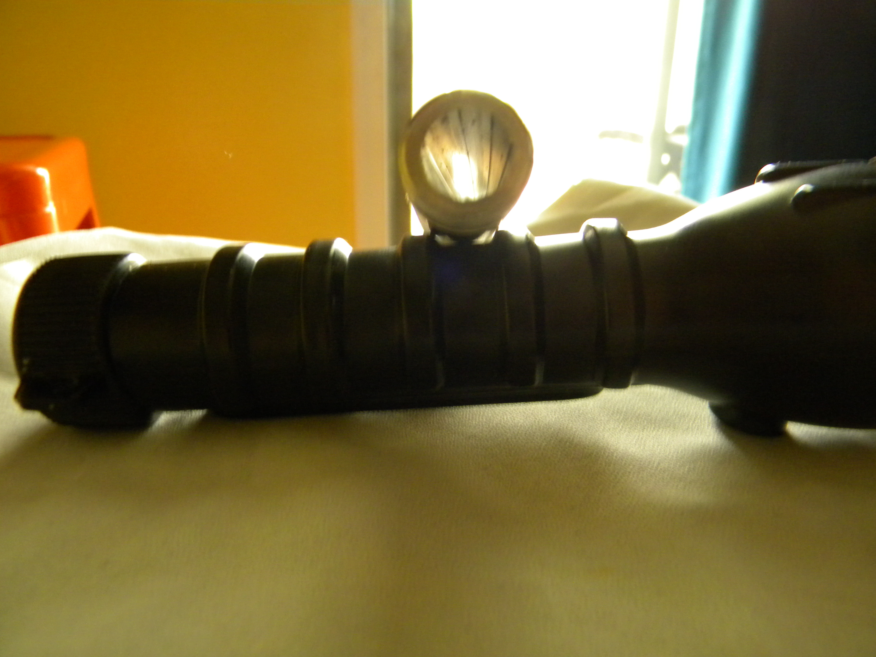

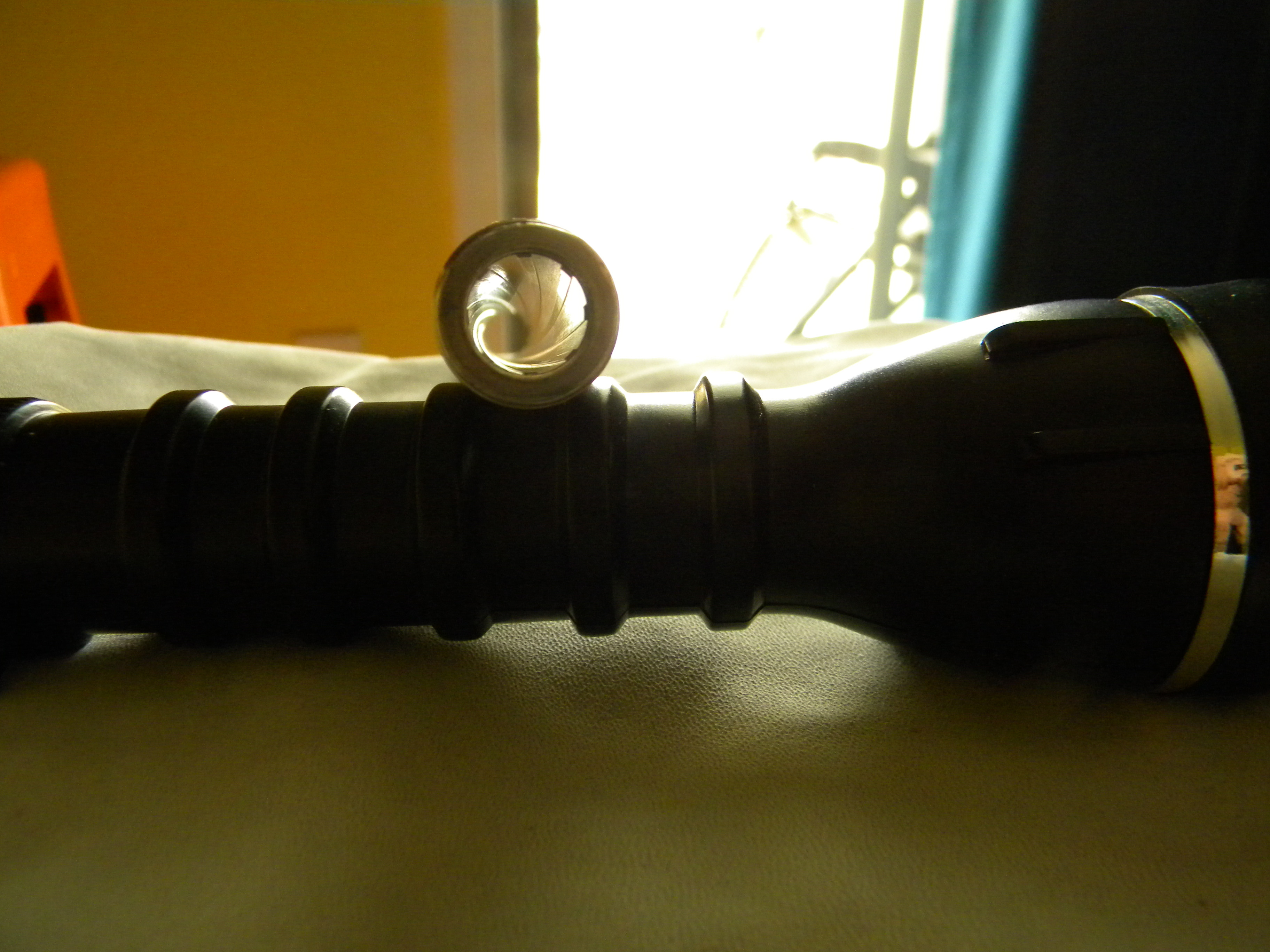

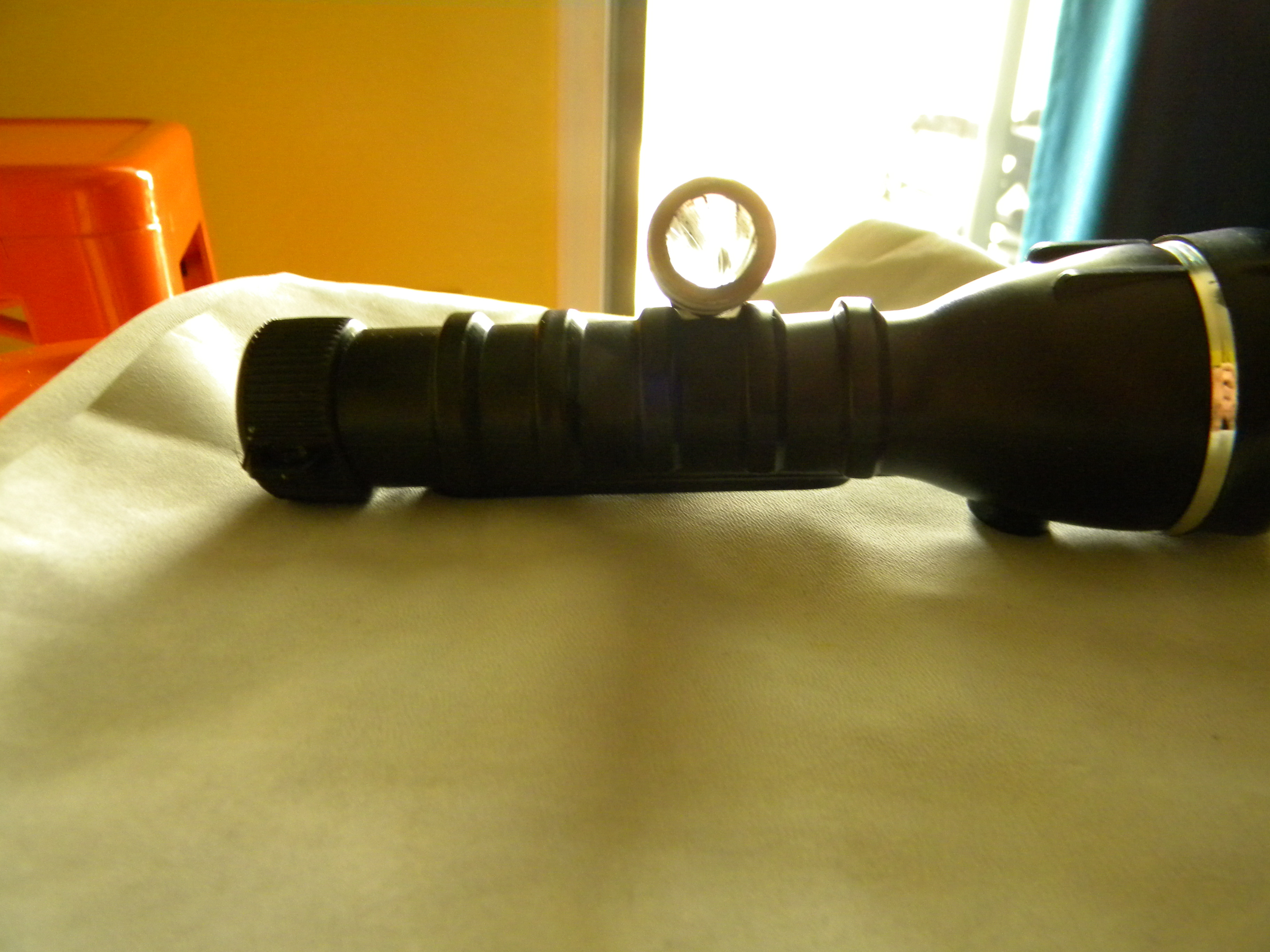

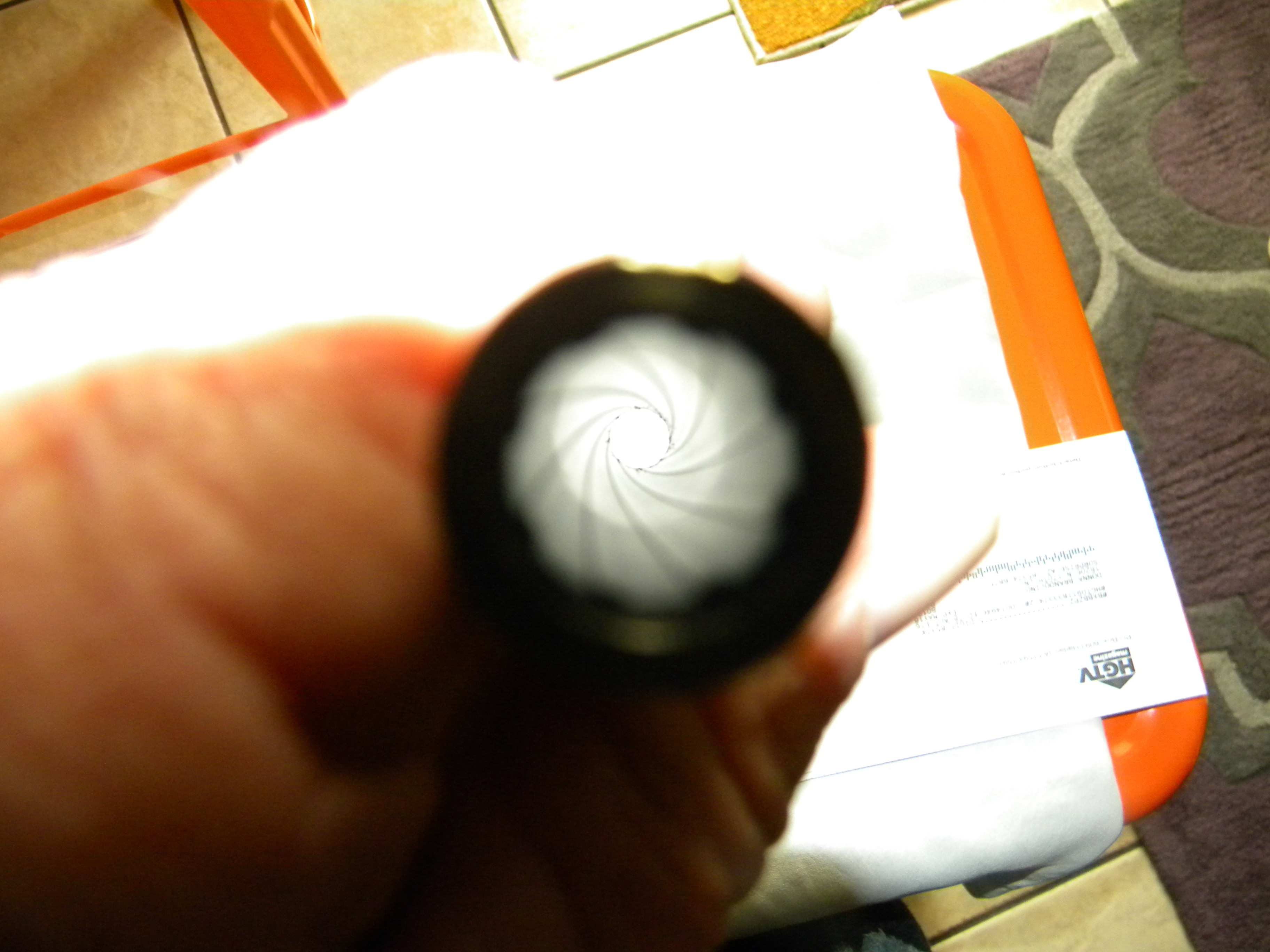

The tiny hump is not at the receiving end. The barrel screws into the frame with no problem. Also, included are pics of the threads at the muzzle end and some inside the barrel. Everything looks good and straight. And some sight pics021.JPGImage Enlarger

January 7, 2017 - 5:28 pm
Looks fine to my eye at least.  The threads seem nice and sharp too.
Is this a used tube or a new barrel tube?  If new, perhaps a drop of oil on the threads and barrel nut will help.
You are saying the tube is tight in the shroud correct?
Is the inside of the shroud nice and clean?
A drop of oil spread on the outside of the barrel may help ease installation/removal.

January 7, 2017 - 5:40 pm
Think I found the problem. There is a tiny nick in the threads 1st or 2nd ring at the muzzle end. So when I tightened down the barrel screw the whole barrel was turning thus the hang up. Should I go to a machine shop or to a GS to have the threads cleaned up ? Tried the oil thing same result.

Are there any of these rear sight assembly's out there for this  baby?
