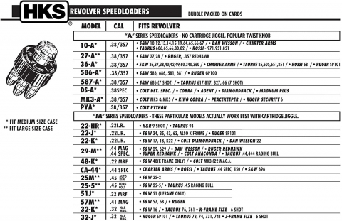

Does anyone know if the .327 mag 5 Star Speed Loader and Loading Block will fit the Dan Wesson Model 732; and
What speedloader is best for the Dan Wesson .357 please??
Thanks, Jack

speedloader-chart.jpgImage Enlarger

HKS 10, not 10A for me. I find the "jiggle" helps when loading SAC or WC loads.
Some don't like the twist to release feature, but it works perfectly with the DW's cylinder release!
I pop the release with the left hand grasp the charger with the right point muzzle up & dump then drop the reloads right in & turn.
Its not easy top do that with a rear release.

Hi Jack, I believe 5 star has a website that lists what model number of speed loader to fit Dan Wesson, I use the HKS 10 and 10A both work fine and are cheaper, as well as easier to find.Safarilands taller speedloader forget model number I have also used and are great for big handed folks.

The SLVariant K-234 also works for Dan Wessons
https://www.slvariant.com/product/k-234-6-shot-k-frame-38spl-357mag/
