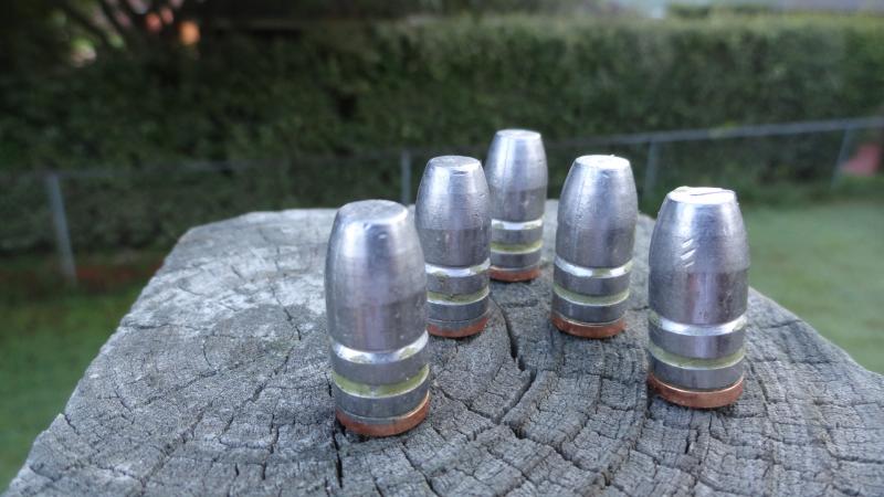

LBT-375.jpgImage Enlarger
May 8, 2016 - 10:52 pm
IHMSA80x80 said
Meanwhile, I will hoard my stash of Hornady bullets, only 5 boxes left.
I'm down to my last box.frown Those Speer 235gr bullets might be good, though. I will have to try some as well.goodluck
