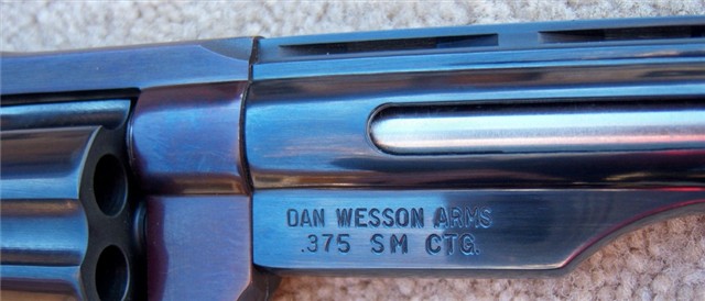

Greetings all!   I've recently acquired an excellent 375 SuperMag, blued in very good condition.   I'm now on the hunt for either loaded rounds (unlikely I think) or brass.  Any suggestions?   I've checked Reed's and they are waiting for another run of brass and no ETA for that.

375 WIN trimmed down to 1.6" does the trick as well…  30-30 works too, but is much weaker and I wouldn't do it, personally.

Can someone tell me what the 375SM is? How does it compare to the 357 supermag. I'm assuming the caliber is larger. Is that correct. I've seen it referenced for years but never really knew what it was. Thanks.

The 375SM is essentially a 375 Short Winchester round, made from a trimmed down 375 WIN cartridge.   Wesson made four super mags:  357, 375, 414 and 445 (not counting the 44Rhinos they did as prototypes to the 445, and independent Rhino conversions).  The 375SM is the 2nd rarest after the 414SM.   I believe the 357SM was the most common (if you can call any of them "common").   I have this in blue....not sure if they made it in stainless?  Would love to find one if they did!
