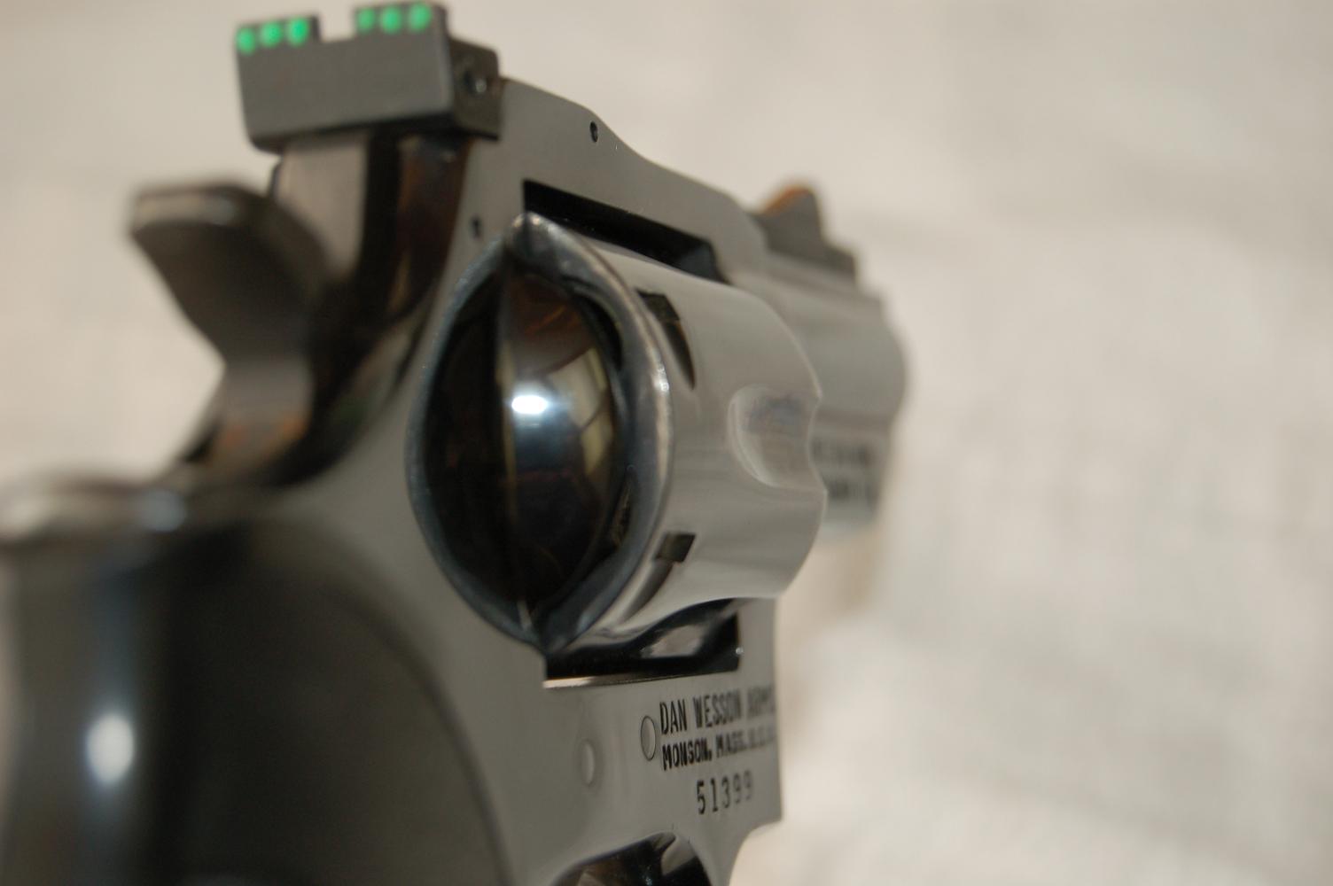

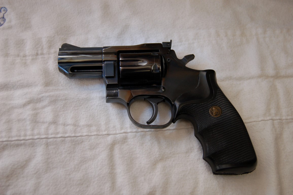

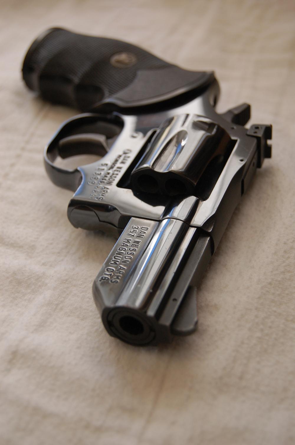

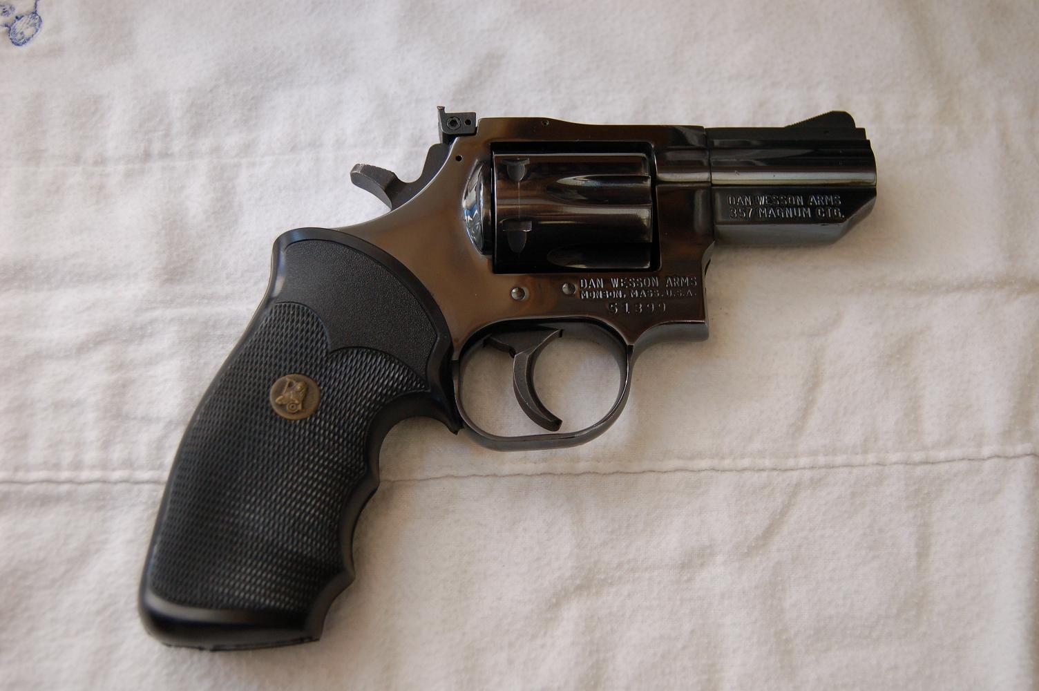

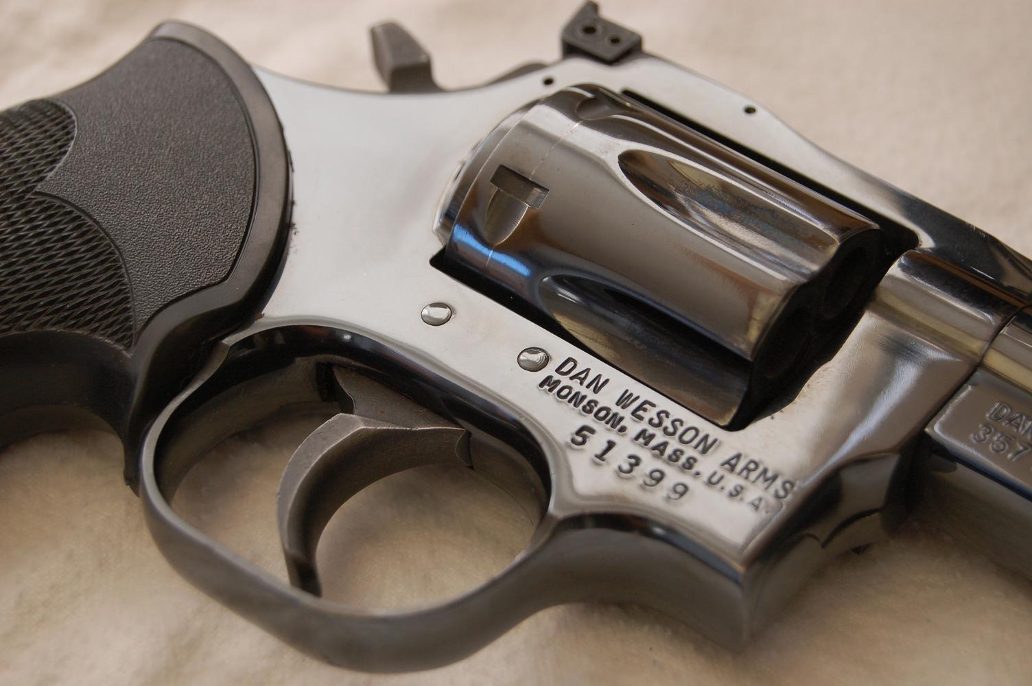

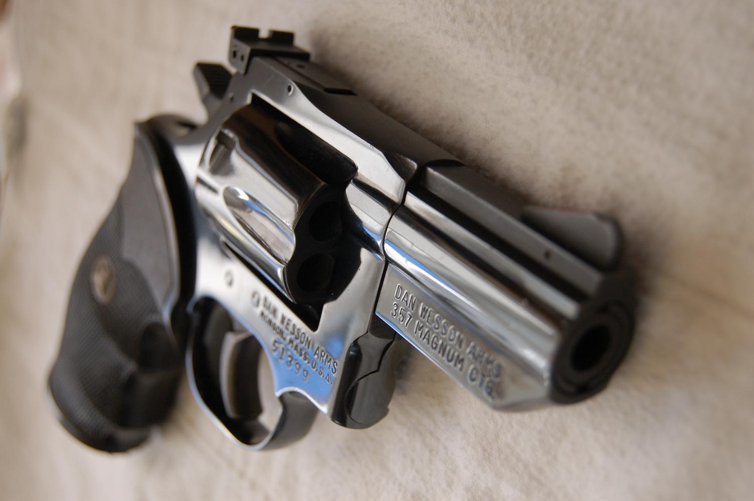

I am new both to this forum and handguns in general. I have done some research and determined that a good first gun is a .357 due to its versatility in ammo for both range and home protection.
I was looking at an S&W 686, but a friend offered his Dan Wesson instead. He says it is a model 15-2, but I am not positive about that. He is asking $400.
I was hoping someone could chime in with an ID on the gun and whether it is worth the asking price.

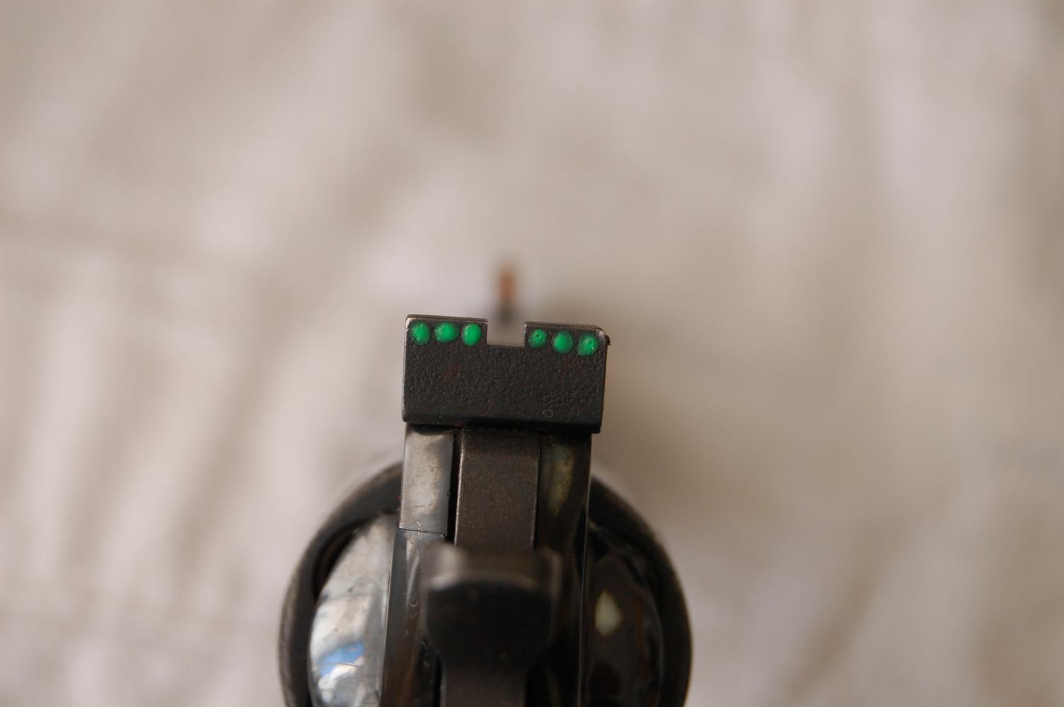

Welcome to the DW place. Yes that is a model 15-2 with a 2.5 standard barrel. The paint on the sights is an add on. Is it worth $400.00 probably. But that is not a steal either. Others will chime in soon.
December 3, 2012 - 6:00 pm
Welcome!  Take a look on Gunbroker.com at recently completed auctions and you can compare your prospective gun to them.  Depending on your area of the country, it could be a good value or possibly not.
December 3, 2012 - 6:34 pm
I'd say that is a 1977 gun (maybe 1976) and the finish looks very good. I has a "2" shroud, actually 2 1/2" with a solid (non-vented) top rib.

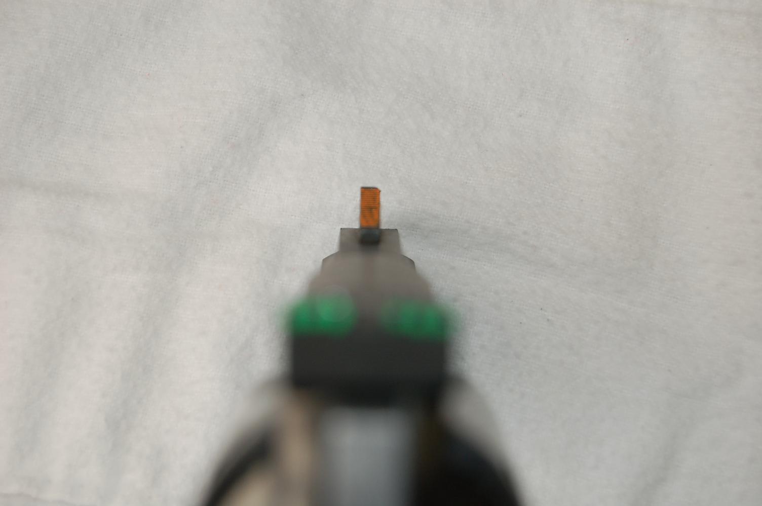

The painted dots on the rear sight are a little funky, the red paint on the front sight is something some shooters did because they did not have the slightly later colored front inserts.
This gun does have the very desirable Pachmayr Grippers, definitely not original, and no longer manufactured. They regularly sell for $40 or more on auction sites.
Bottom line, this is a good gun if a snubbie .357 mag is the right gun for you. This will be a tough, reliable, quality gun.

It sure looks like a model 15-2 to me.
I would personally take the paint off the sights, but it wouldn't keep me from buying the gun. If it bothers you badly enough, know that both sights are removable and not staked in. They can very easily be changed or replaced.
I would want to know if it came with anything else, like perhaps a barrel wrench, or any other barrel and shroud combinations, since they would also add to the value of the gun. If you do desire a 2.5 inch snub nose revolver, it's not a bad gun, or a bad deal IMO. If you decide you want a different barrel length, you can always get one for it later. If the gun does not come with a barrel wrench, plan on adding one of those as well. EWK sells a great barrel removal/installation tool for $23.00

Welcome from PA. Like the guys said, that is a 15-2, a fairly early one. If it looks as nice in person as it does in the pics, I would say $400 is right on the money. That bluing looks nice! You can look at Gunbroker auctions as a guideline, to me it is always a benefit to buy a gun you can hold and check out in person first.
   If you have read other threads here, you know the barrel is interchangeable on that Dan Wesson. You could pick up a barrel tool and a 4" or 6" barrel assembly which would be nicer for target shooting and still be under the price of a 686.

This would be a 15-2 from 1975 or early 1976, colored interchangable sight blades were introduced in 1976. This style shroud with fixed sight blade followed the pork chop style for a short time before the colored sight blades, not a model 14 shroud.
Nice Dan but 400.00 is top value for this one.
