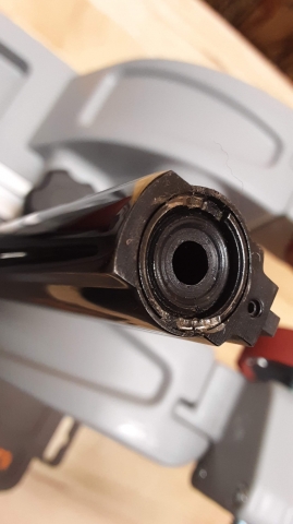

Post a picture of the nut.

December 27, 2018 - 11:45 pm
20181227_203507.jpgImage Enlarger

December 28, 2018 - 8:55 pm
Somebody did a number on it, but you don't need much to grab on to when you clamp it down.  Put some heat on it also.

I've got some 1/2" pipe clamps, my plan is to put a penny on the breech end of the barrel and try that. Now I'm applying Kroil to the threads a few times a day and letting it soak in. If I need to get more serious than that it may have to wait until I get back to my shop up north.
 I'm the somebody that did the damage. The initial damage happened when the pilot of the plastic wrench broke off while attempting to loosen the nut to adjust the gap. I don't remember what I did after that to complete the butchery, it was about 30 years ago.
 The problem is that the gap is a little too tight and there is a slight drag on the rotating cylinder, just enough to make double action shooting impractical, and manual cocking balky at times. I recently traded into a Smith&Wesson 617, shooting that made me realize what a great revolver the Dan is so I'd like to get it into top operating condition.

 The nut is off!
 I put the gun in a vise with the barrel pointing up and periodically applied Kroil to the nut until it ran out past the threads at the frame end of the barrel. I used an 8" C clamp, my new EWK wrench and a 1974 penny (oldest one I could lay my hands on). It took considerable effort, but came apart perfectly.
