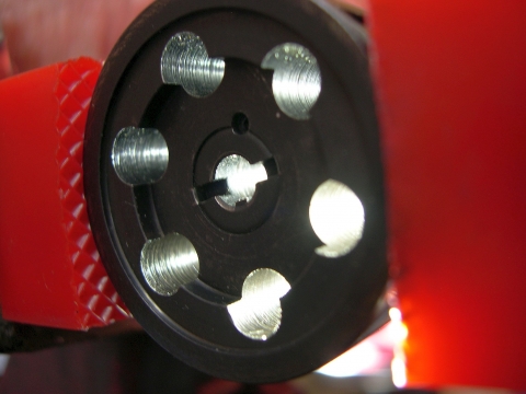

StuO
Forum Posts: 5
November 25, 2017
June 28, 2022 - 3:11 pm
md8232 said
I picked up my .22 today.  Had my Smith polish the chambers and he said they were very rough.  Not Dan Wesson’s finest work.
Busy playing with my new Sig 10mm today, so will try the Dan tomorrow and report back.
I hope it works for you.
Messed-up-chambers-1.jpgImage Enlarger
