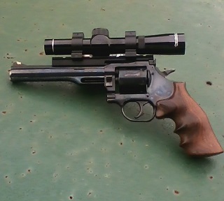

Sent my DW 22 lr revolver to the Norwich plant for a 22 magnum conversion.  I had the same question for the gunsmith.  He said to go ahead and shoot the 22 lr barrel.  There is only a .002 difference.  Below is a pic of my gun, with an unfluted 22 mag cylinder and original factory 22 lr barrel.
