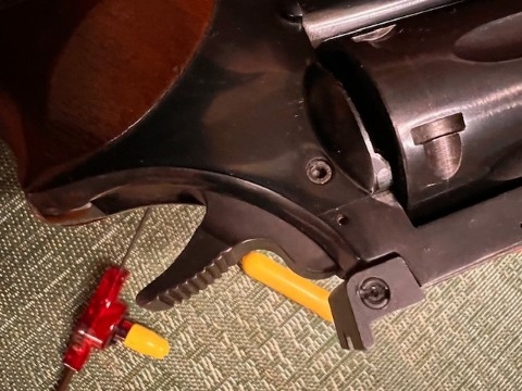

I hesitated to start another rear sight thread but I did read everything I could find here and I couldn't find an answer. After reading one from the Shootist started in 2010 I was going to tack onto that one but it looks like he hasn't posted since 2022. I hope he didn't pass.

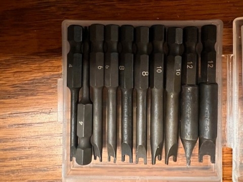

My rear sight seems to work opposite of what I found in an old Dan Wesson Owners Manual and I am trying to figure out if it is related to the lock nut that captures the windage screw. I bought a cheap set of Chinese spanner bits that are roughly machined (shocking) and the No. 4 fits the closest but poorly. I don't want to damage the outside ring on the nut. I did try tightening the nut a little and it moves the hex head windage screw on the right when I do that. So I think the nut is actually tight enough.
When I rotate my windage screw counterclockwise with a hex wrench, the sight moves to the right, AND the nut rotates with the screw. I can feel the detents as I do that but they are not very crisp but they are there. The further out I go with the adjustment the more faint the detents feel. If I rotate the crew clockwise the sight moves to the left. This is opposite of anything I have found online or in the old manual. I am thinking it has something to do with the fact that the nut is turning with the screw. I did watch a Midway YouTube on a Smith and Wesson sight and at the end Larry Potterfield peened the slots in the nut outward using a center punch. I certainly don't want to do that.
Any thoughts on the nut turning with the screw and the apparent reverse direction for adjusting?
