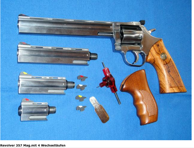

I have a chance to get a 15-2 pack 2",4",6",8" in case (auction price?)
Monson 83873 /1976?
What do you guys mean about the better prod. years on the 15-2 ....end of 70's,
.....middle 80's?
Or is it sh.t !!
Wesson dies 1986 and the later prod. wasn't  the old prod. i often heard!
THX guys for every answer!
http://s1.directupload.net/images/130218/xnezilu3.jpg

Can't really help you on your question, but instead wanted to inquire about the grip on the gun you have linked. Is it yours? Or is that the one you are looking at? If it is your's would you mind sharing info about the grip? That's really cool lookin and never seen one like that.

No that is what i looking for.
