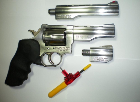

The blued model 14-2, and stainless model 714 Dan Wesson revolvers have a non adjustable (fixed) rear sight groove machined into the back of the pistol.
The model 14-2 (and 714) use a shorter front sight blade than the model 15-2 and 715's.
I've posted the picture below before, since it shows a few different front sights installed on my fixed/service sight model 714 Dan Wesson revolver.
Model 714 revolver with 3 different barrel assemblies, and front sights.
Dan-Wesson-3-diff-barrels.JPGImage Enlarger
The top 6 inch barrel has an incorrect model 715 front sight installed.
(Which is too tall, and does not shoot to the correct POA/POI)
The middle (installed) 4 inch barrel shroud has an EWK arms model 14 conversion front sight installed, that allows you to use a Model 15-2 or 715 shroud on a model 14-2 or 714 revolver.
The bottom 2.5 inch shroud is the model 714 shroud that came with the pistol, with the factory correct height model 14-2/714 front sight installed.
EWK arms sells quite a few different front sight blades options for Dan Wesson revolvers, including adjustable partridge front sights, fiber optic front sights, and the model 14 conversion front sights, which are nice if you want to use a model 15-2 barrel shroud on a 14-2
Link below.
http://www.ewkarms.com/zen8/index.php?main_page=index&cPath=67_9
Hope that helps clear up some of the confusion.
- Bullwolf
