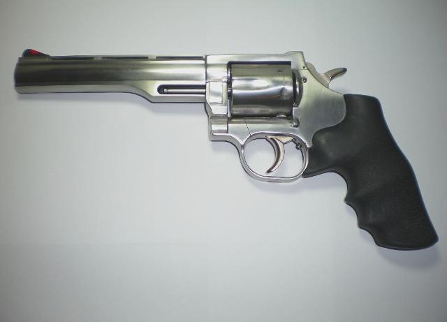

Here's my take on a Bianchi holster, specifically the Bianchi 7000 series.
Let me preface this though by saying that holster selection is a very personal matter, and will vary much with your intended use.
I've been using a Bianchi 7000 black nylon Sporting Holster with my Dan Wesson, much like the 6 inch one in both the image and the links below. A 6 inch barreled Dan Wesson model 15-2, or 715 fits in this holster quite nicely.
Bianchi 7000 Black Sporting Holster Fits S&W K Frame 6 inch.
qid=1440656945&sr=8-2&keywords=bianchi+7000
Or the 4 inch version which will fit a 15-2 with a 4 inch barrel assembly exceptionally well.
Bianchi 7000 Black Sporting Holster Fits S&W K Frame 4 inch.
qid=1440656945&sr=8-1&keywords=bianchi+7000
The holster was quite inexpensive at only $30 dollars with free shipping when purchased from Amazon, and has proved to be one of the better purchases I have made. The only criticism I have is that the Velcro adjustable retention strap also threads through the belt slide. If you wear a very heavy or thick belt, it can sometimes be a challenge to repeatedly thread it through the holsters flexible (injection molded) belt slide. However, for the price point I simply deal with it, since it seems to be it's only shortcoming.
I prefer a nylon holster, as I am hard on leather. Any leather holster I use eventually gets wet. For me leather holsters often mold, and require extra maintenance. My leather holsters also seem to be harder on the finish of my guns, and they tend to abrade away blued finishes. (you'll see it first on the muzzle, and other friction points of the pistol in the holster)
For all those reasons, I chose the inexpensive Bianchi 7000 holster for my Ranch use holster. I keep my workhorse model 714 Dan Wesson (stainless .357 with a fixed rear) in a Bianchi 7000 series for all of my walk around chores.
Left-Side-Dan-Wesson.JPGImage Enlarger
In my case the gun and holster both get quite sweaty and filthy. The pair see chainsaw work, tractor time, and lots of other dusty environment use. When all done I simply blow the debris off, and out of the holster then wipe everything down.
- Bullwolf
