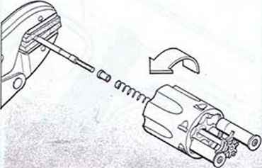

Reb- if you feel you need a shim, try here; DW is near the bottom.
RamblerReb
Forum Posts: 33
December 13, 2013
January 3, 2014 - 12:50 pm
Thanks for the diagram and link, but the site says thst those shims are for the large-frame DW, which I understand the 14 not to be.  Am I missing something?
Forum Posts: 5445
January 3, 2014 - 3:21 pm
Nope- wasn't paying that close attention.  Give them a call with the diameter and thickness you want, they probably can come up with a match.

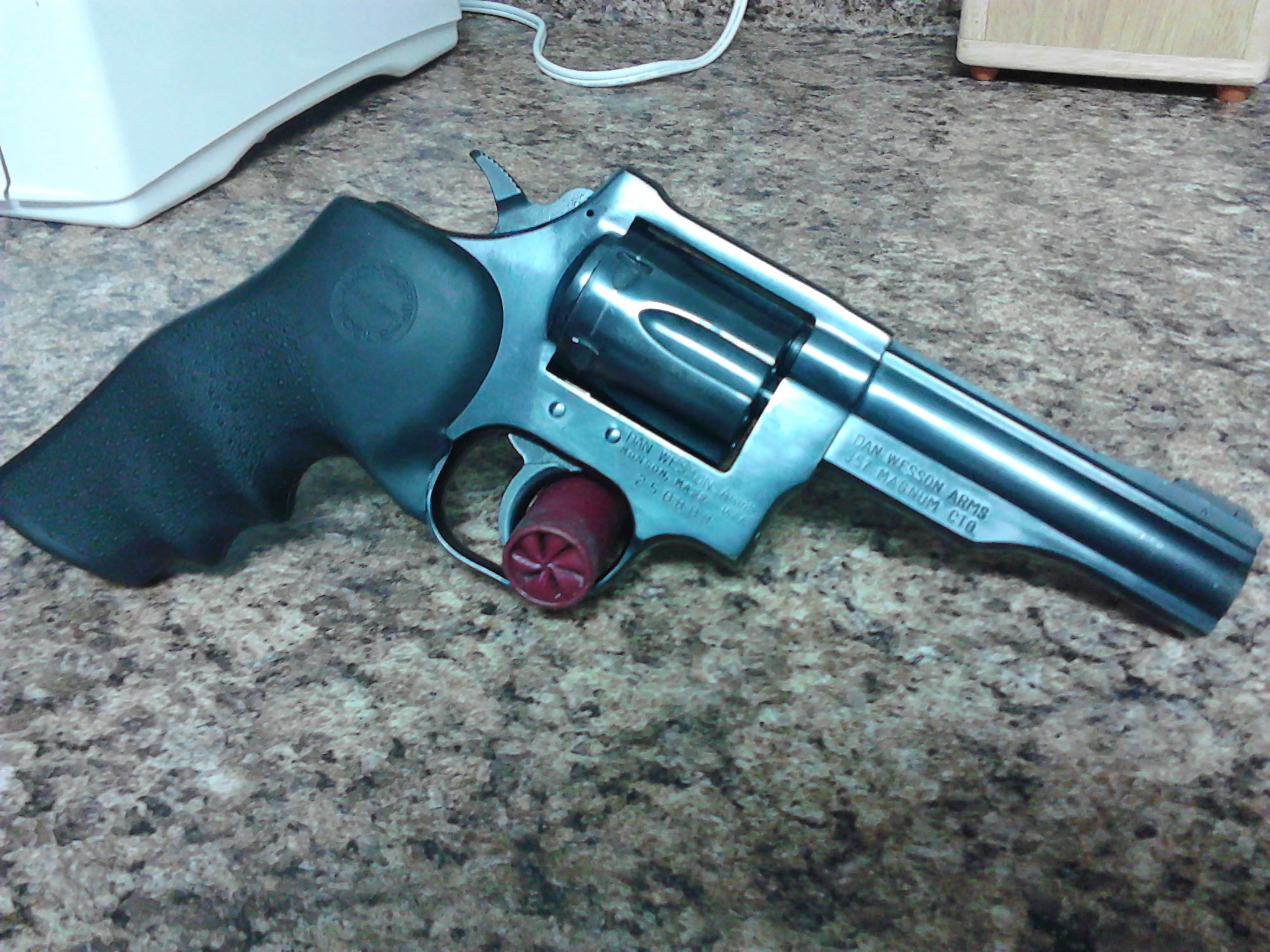

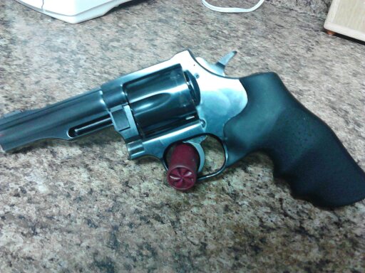

Not sure why know one has asked but show us that Dan! Several things maybe handle by some well taken pictures.
Is the ball or spring even in it?
Keep us posted and post up front and side view of you DW!

Dan14-2-008.jpgImage Enlarger
Dan14-2-006.jpgImage Enlarger

Nothing looks wrong as far as the pictures go!  Thanks for adding them!   Pinned front sight, maybe just a 15 sight would fix it!   The end shake needs to fixed then see where you are on the rest!

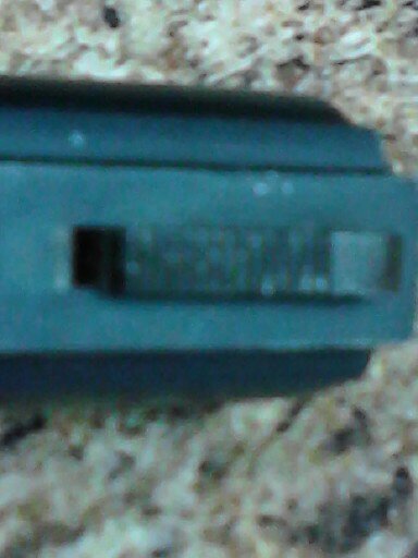

January 28, 2014 - 11:18 pm
Maybe it's the angle of the picture but your front sight looks short even for a model 14-2,
can you take a shot of the front sight  ? Does it look like it might have been filed down ?
32
January 28, 2014 - 11:26 pm
Agreed. that front sight looks very short,  that could be your problem right there.  EWK sells nice front sights in a variety of heights.  I think they come in an assortment for not much money.   You could experiment until you find one the brings the POA/POI more inline.
It's broken in two places, in front of and behind the tang where it is pinned to the shroud.  It doesn't look like there would be that much of a height difference if it was intact, though I could be wrong.
If you click on the second image in my post above and enlarge it you will see the crack in the front of the sight.  The rear part is missing entirely.

Here are the best pictures I could get:
Dan14-2-005-1.jpgImage Enlarger
38
January 29, 2014 - 1:08 pm
That blade looks very short to me and compared to my 14-2 sight.  I have a 6"BA somewhere around here I'll try to post a pic of it.  It has much more of a rise in the front.  I think that blade may be the problem.  As short as it is, you'd be holding muzzel high to get it in the notch and that would make your shots way high.

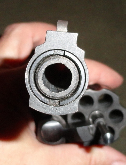

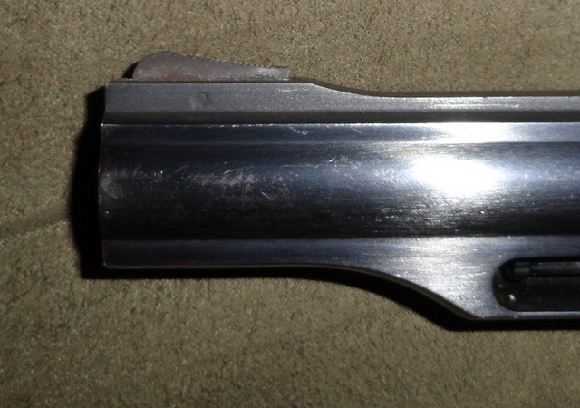

Other than being broken, it looks right to me but maybe the hump is filed.  My model 8 for comparison is below.  I'd think maybe barrel issues?  What does the crown look like?  Is the forcing cone buggered? Does it appear to be threaded straight?  I'll go take a measurement...  looks to be 4mm above the rib.
DSC01120.JPGImage Enlarger
DSC01123.JPGImage Enlarger
DSC01122.JPGImage Enlarger
