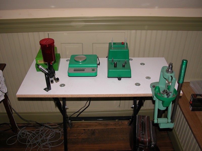

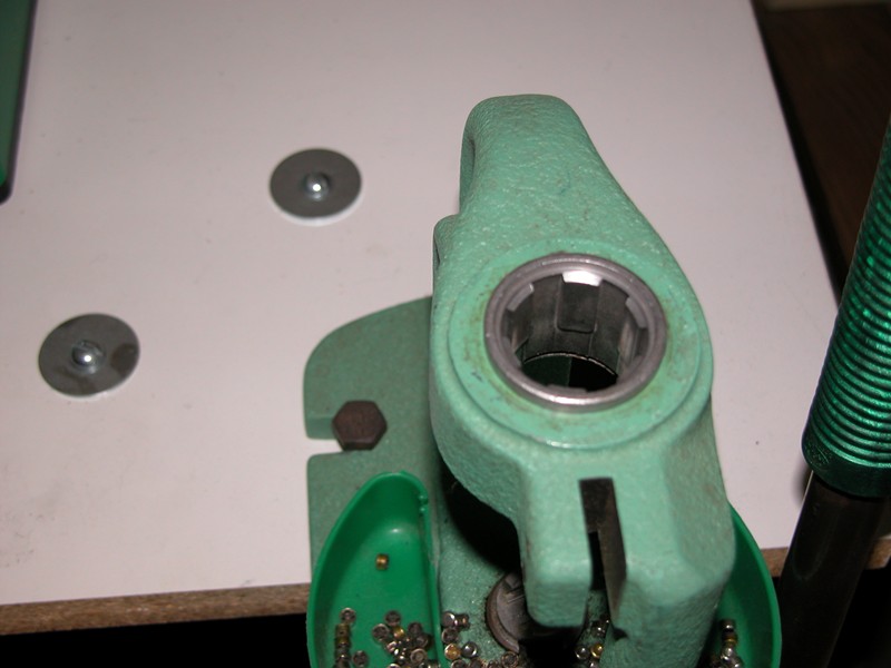

It's only been in the last year or so that I've started reloading.  Took an NRA Reloading class at my club.  My Dad and I had picked up a used RCBS Rock Chucker before he passed away.  As others have stated it's a very sturdy press.  I have switched out the bushing and replaced it with a Hornady Lock-n-Load bushing.  This allows you to quickly change the dies.  Once you set then in the bushing you're finished.  To change then you simply give them a 1/4 turn and they come out.
Below are some pictures of my bench:

Regardless, thanks guys for all the help, you've given a ton of good advise & pointers that I can use. Jody, I can see why that lock-n-load bushing would be an advantage. That's a neat idea they had, right there.Laugh

JODY  QUESTION REGARDING YOUR LOCK-N-LOAD BUSHING..DO YOU HAVE TO
buy special Hornady Lockn-load dies or can you use your regular dies and .. then what.
is there a bushing you thread over your dies that allows this lock-n-load feature to work   or what ??

The Hornady LnL bushings will work with other manufacturer's dies. I guess I should have mentioned this as an option for those using a single stage  press.
