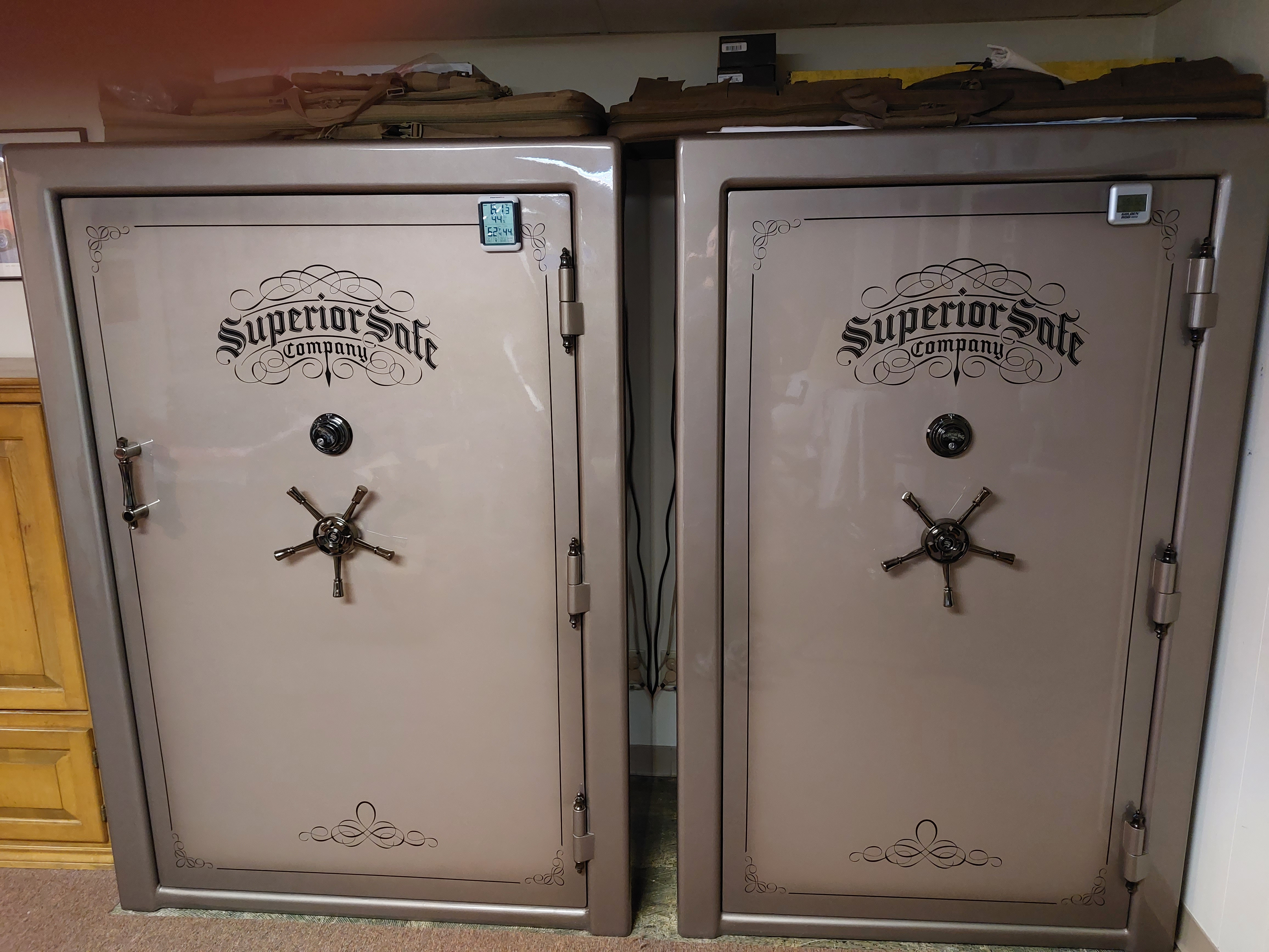

(DW #25 ships Tuesday.   Second safe goes on layaway tomorrow)

Keep us posted on your endeavor.
Heading for number three.
