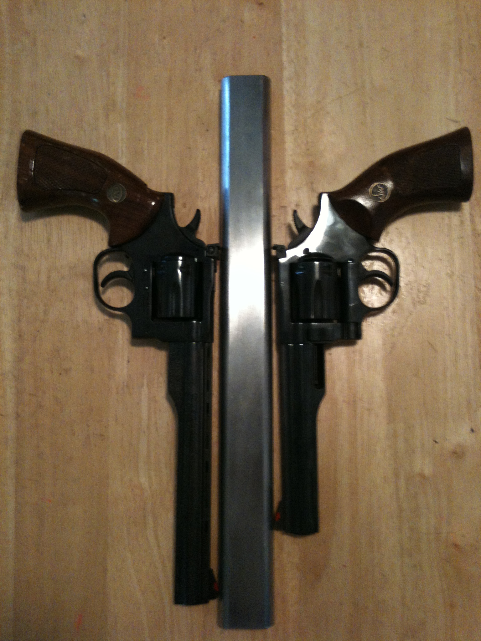

So, first up is the original shroud blank, with the two "transplant" recipients. :) photo-6-1.JPGImage Enlarger

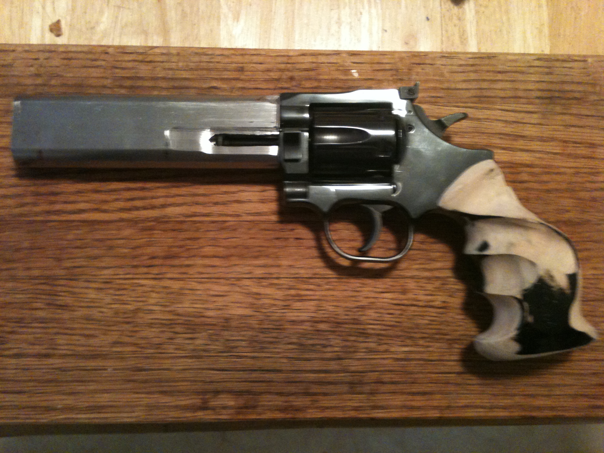

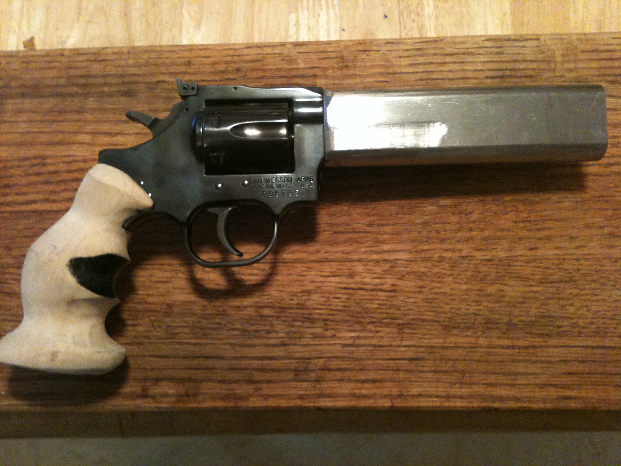

 Still more work to do, not ready for testing, but I am happy with how the first one is turning out. And SOLID, to boot! I think that the 4 inchers are going to be my favorite - just a hunch. And that is why I love these Dans! Any other frame, and I would be having to BUY 6 different GUNS!

Even though the 6" shroud does not yet have the counterbore for the barrel nut, it feels comfortable, and with the larger of my 2 factory grips does not feel like it wants to nose dive. I am redrawing my fingergrooved grip to incorporate some of that geometry better, I sanded it down a little too far.
I love the EH shroud stock, go order some barrel assemblies from Eric! (I really think it should be called the FH shroud, 'cause that is how heavy it is! HA!)

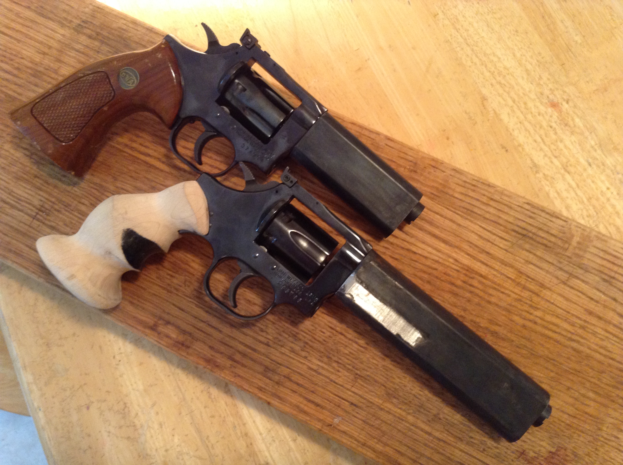

4 and 6 in. shrouds with a 'temp' bluing. Hot bluing will wait until done.
You can tell that I have not yet been able to counterbore for the nuts.

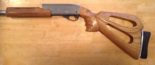

Here is one of the other projects that I have spent a little time on while waiting for a mill.
870 Wmaster wearing a sort-of-trap-style stock. It's oak, it's for skeet, and it's to fit my build.
870-skeet-proto-oak.jpgImage Enlarger
Foregrip is plywood. I got it for 8 bucks, and am looking for big forstner bits, to carve my own.

Unusual, but not to bad. Slots in the butt to lower the Oak weight or ornament? Forearm looks really good to be Plywood.
