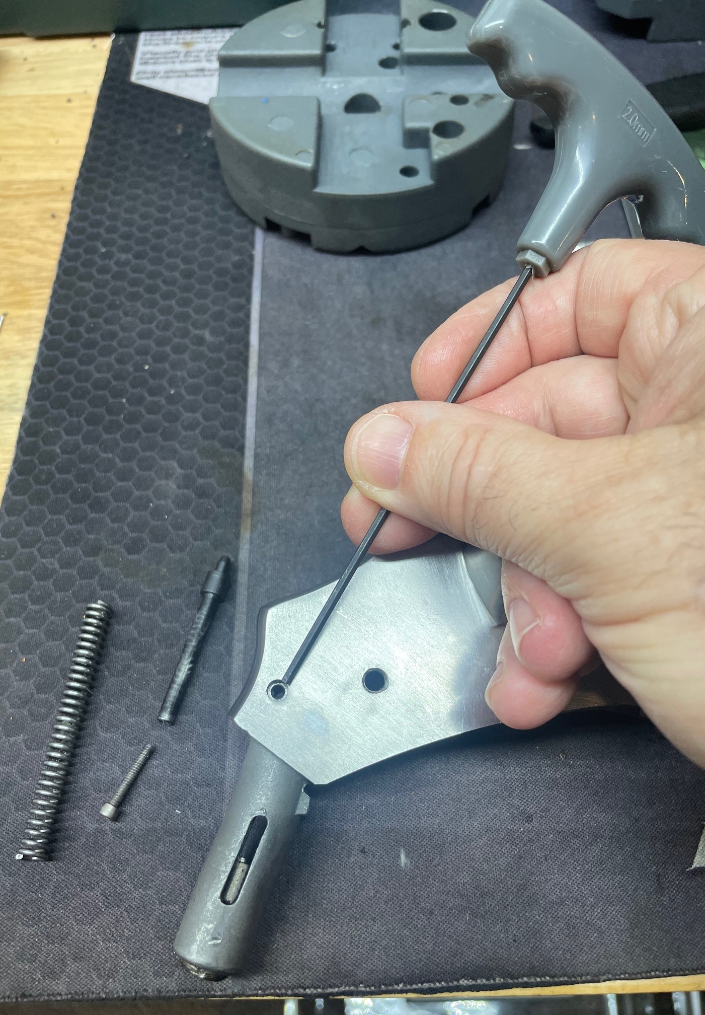

Right- no reason to remove the main spring seat.  Just unscrew the long side plate screw from the bottom of the main spring guide and Bob's your uncle!
Ron- the hole that I've pointed out is where the screw resides on the 740 I have disassembled.

Let me expand a bit.
I was shooting this 375 today and I was getting alot of light strikes with failure to fire, in both single and double action.  It wasn't the grip screw. While cleaning the gun, I noticed the main spring seat had backed out about 3 threads, despite the fact somebody staked it in place several places.  I think this was the cause of my light strikes.
I'd like to replace the seat as the threads on the end are rough and marred by staking.  I figure to replace the spring while I'm at it.
I plan to use some Loktite when I reinstall the new seat.  I just don't know how to screw the new seat in as it has no flats, or screw slot.

February 20, 2024 - 11:05 pm
You could bottom out the grip screw or use a shorter screw with the same thread or get a nut and tighten it down on the new plug to install the new one. I’d find a nut if it were me and the new plug didn’t screw in by hand for some reason. Cleaning up the threads on the frame if needed with the proper size tap would be the best way. Then the plug would/should screw in by hand. I’d do the loctite and still stake it.
February 20, 2024 - 11:40 pm
I like the jamb nut idea Superdan.
Just so I understand, remove the hammer, pull out the spring and guide pin, then remove old seat, chase the threads  and install a new one with a screw and jamb nut with loctite and stake.  Then reinstall the guide rod, spring and rest of internals.
Seems straight forward enough.

February 21, 2024 - 7:15 am
Sounds like a plan. The chasing is only necessary if the threads on the frame are damaged (still have the old staking remnants). Watch your eyes when installing the spring and guide. Find something that goes over the end so that it doesn’t slip off then get the small screw engaged in it to capture. A hollow rod, drilled out wood dowel or maybe a small universal screwdriver without the bit might work.
