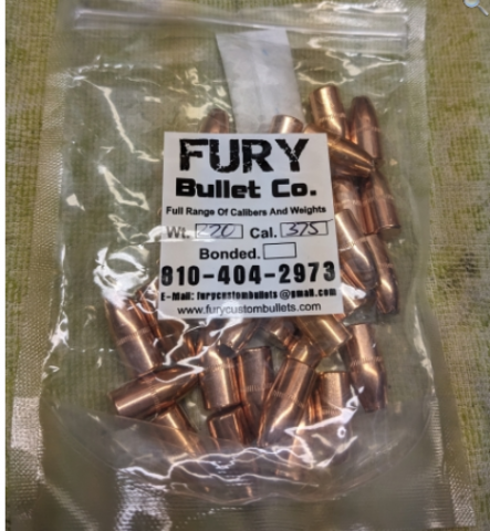

You can get brand new 375 Supermag brass at quality cartridge. It's not cheap ($2.50) but once you but it then it's re-loadable. This is made for the Supermag brass so no trimming. It's also not always in stock. Also two places to get bullets. Les Vollmer custom bullers and Fury bullet Company. Screenshot-2024-04-01-12.18.28-AM-1.pngImage Enlarger
