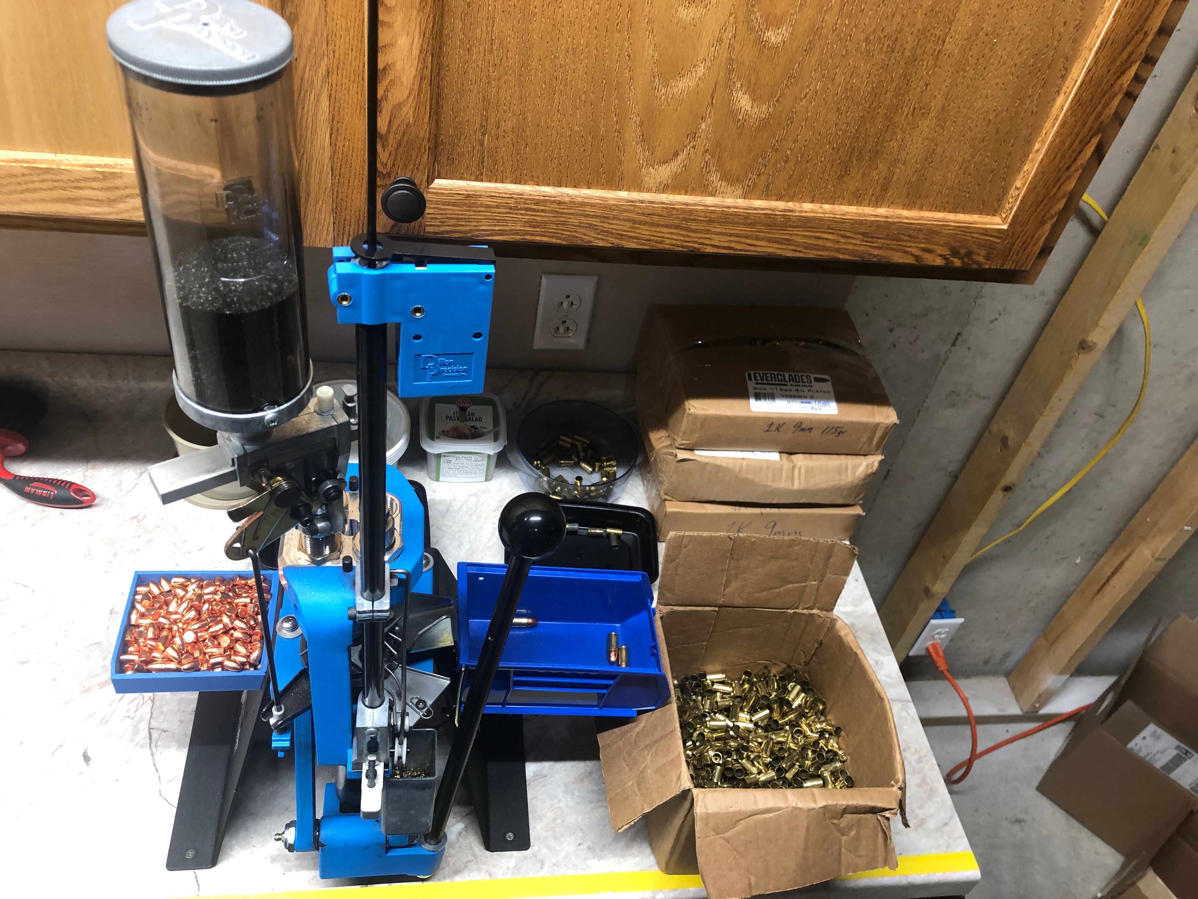

February 17, 2022 - 9:08 pm
B68B0F0C-4F47-491F-8102-7BFC574D2BAA.jpegImage Enlarger
I have a Dillon RL550B and really like it.
You’ll probably also need:
1. 5 gallon bucket and a sifter to separate tumbled brass from the media.
2. Corn cob media and an additive like Flitz media additive.
3. Primer flipping tray
4. Impact bullet puller
5. Timer to auto shut off tumbler
I’ve had a hard time finding large and small pistol primers for a fair price for a year now.  Finally found gun powder (Hogdgon Tite Group) recently for fair price.
I’m still fairly new to reloading myself. So far I’ve loaded 3K rounds 9mm 115gr jacketed round nose.  I’m gonna also do 45ACP, 45LC, 44 mag, 357 mag, and 38spl.
