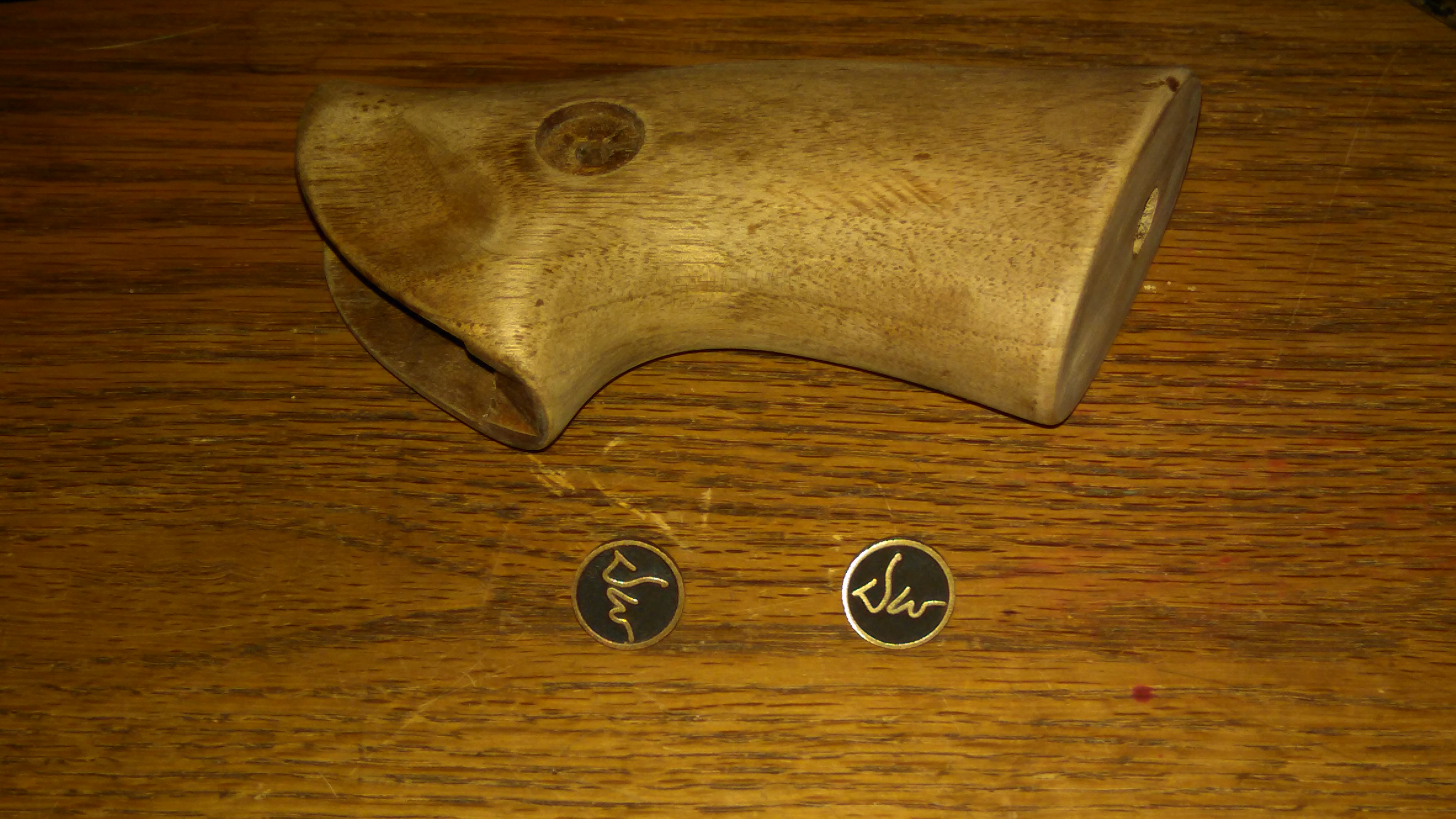

Now feeling inspired... A trip to the garage with the 44 grip... stripped with the above Formbys refinisher and steel wool... fresh black and a quick trip over some 400 grit... Some Formbys tung oil, probably 10+ coats...
