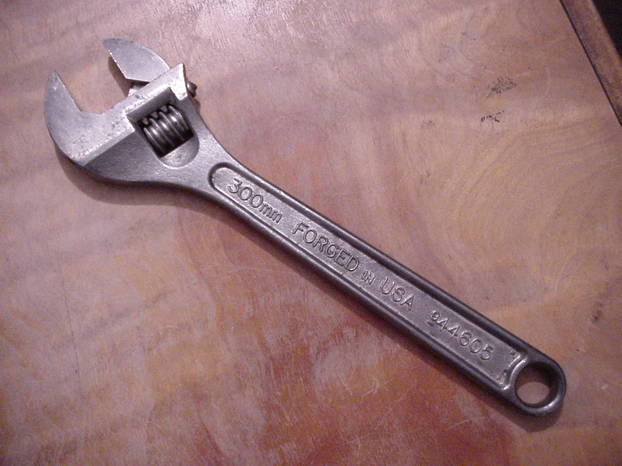

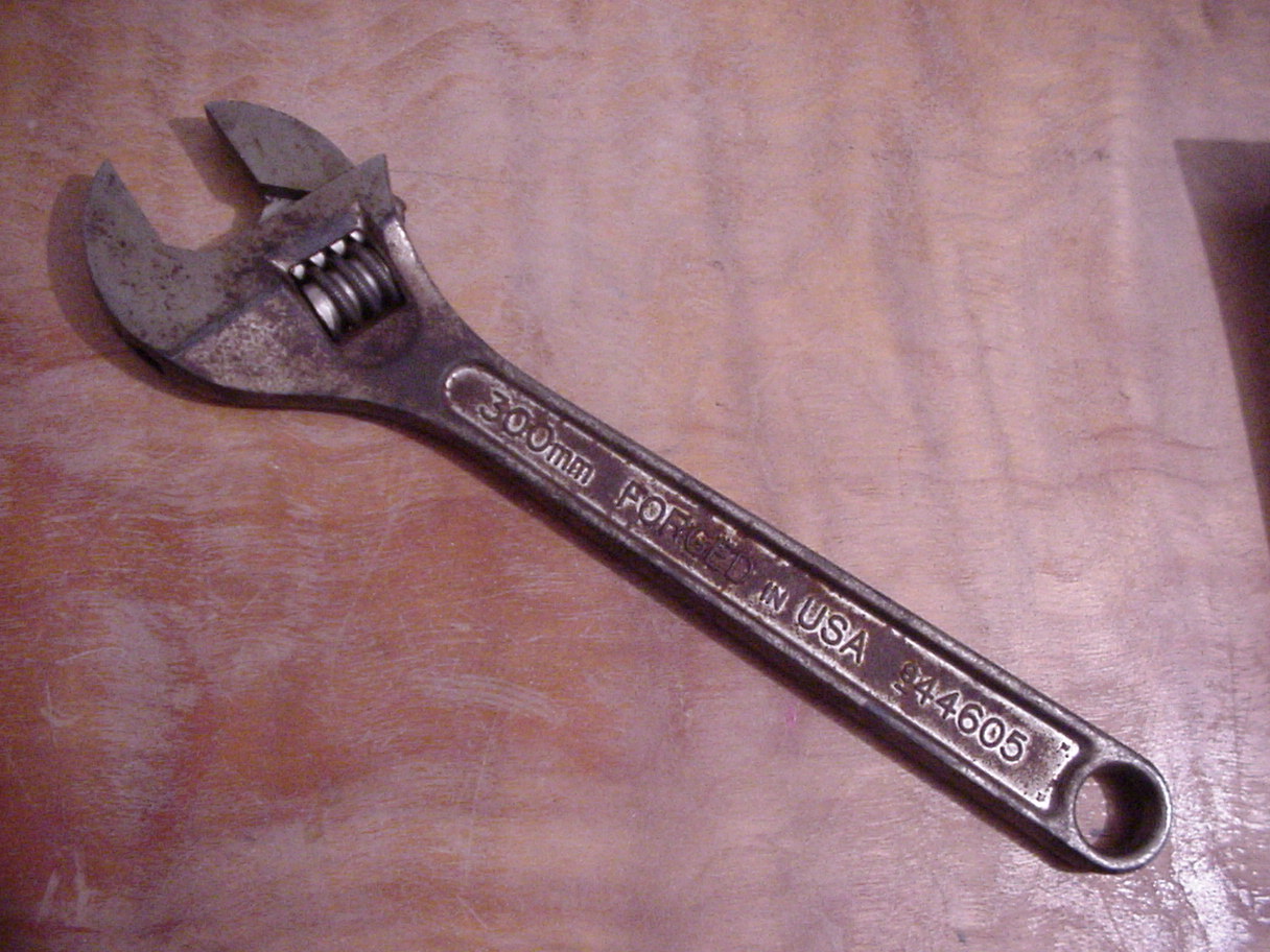

Not to hijack this thread, but here is the first project I ever used my electrolysis tank on...truly amazing...
before
After

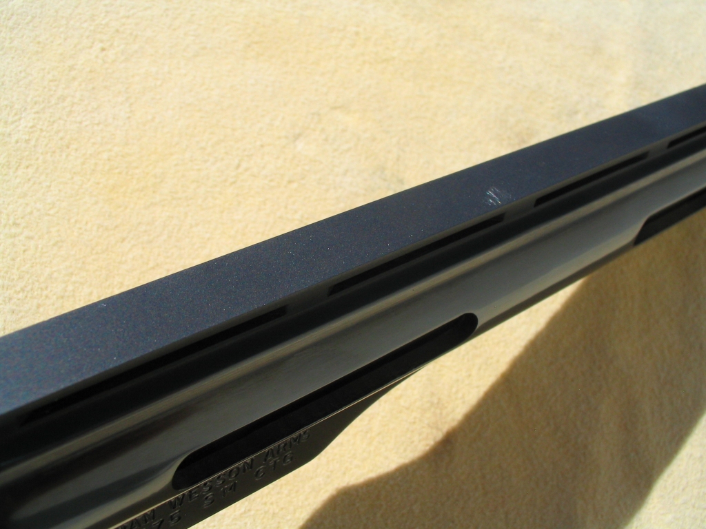

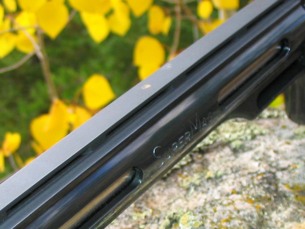

As promised, before and after photos. Sorry it took so long to post. Notice the scratch mark above the brass mark on the before photo for reference when looking at the after photo.
Before:
Brass Spot from B Square mountImage Enlarger
After (the brass mark would have been above the scratches in this photo):
After Copper SolventImage Enlarger
It took about 5 go arounds of: drop some copper solvent on the brass spot, lightly rub with Q-Tip, wait 5 mins, brush off with Q-Tip. Repeat...
