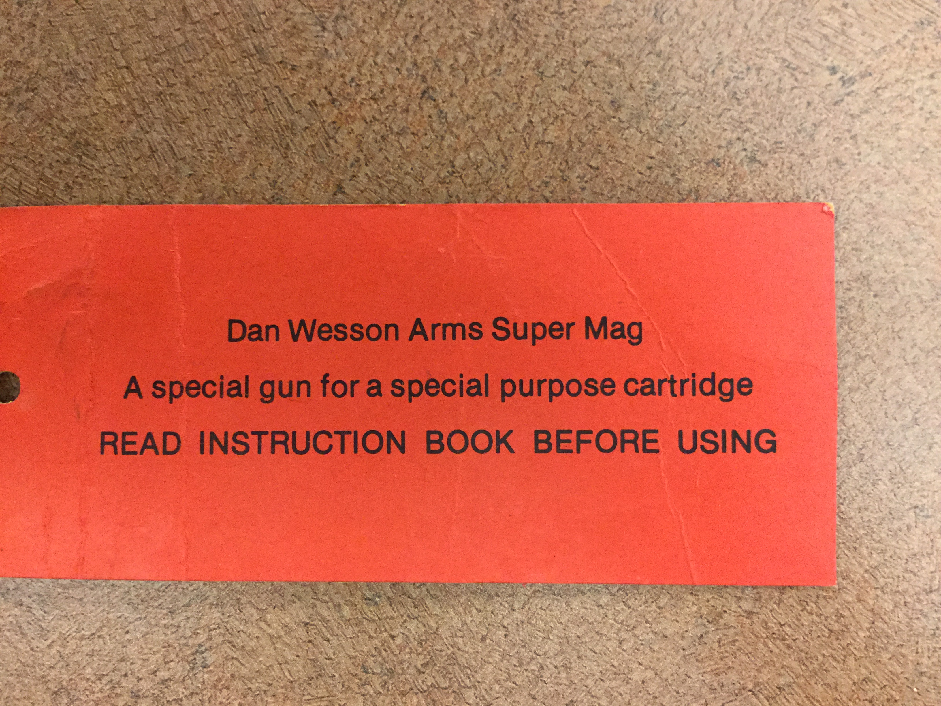

 Just purchased a 1983 Monson Mass .357 Super Mag with a 10" Barrel. I also have about 140 rounds of Jamison .357 Maximum ammo with a 158 Grain Bullet.  As soon as I shoot some of this Jamison Factory Ammo, I plan to reload this "new to me" cartridge and have a few questions.
#1.  What reloading dies are you guys using for .357 Max?  I have been reloading .38 Special and .357 Magnum using .38 Special Lee Dies and I am wondering if these dies will also work for .357 Max or if I am going to need to get some new dies.  I have a feeling the .38 special dies just won't be long enough.
#2.  I have the Sierra Reloading Manual and so I have some Data as far as powder and bullet combos, but what are you guys using?  Anyone have some bullet and powder combos they are willing to share?  Anyone have some chrono data they are willing to share?  I will be posting my results once I get started and get he chrono set up.
#3.  Do any of you shoot .357 Magnums in your Super Mags?  or do you only shoot Maximum out of your Super Mags?
Thanks for any help/advice.  I can not wait to christen this fine firearm!!!!!
Super-Mag.jpgImage Enlarger
