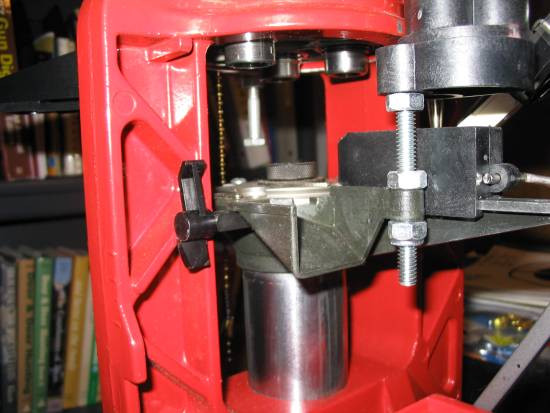

I've got a Lee Loadmaster Progressive Press.  For 41 magnum, I have die set #90628, which includes the sizing die/decapper.  This is in the first station, and it resizes the empty brass case and pops the used primer out the bottom.  The old primer drops into the ram.  In the bottom center of the picture below, you'll see the ram.  It is the silver steel cylinder.  I oil it with 10w30 motor oil.  (I have a couple of quarts of it from previous vehicles; my truck uses 0w20).

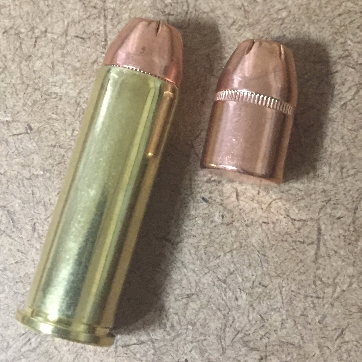

In station four you'll find the bullet seating die.  It is adjustable, which seats the bullet deeper or shallower into the case.  I generally use the cannelure as a guide, because I've found that seating to the top edge gives me an overall length of between 1.575" and 1.580".  Bullet seating is facilitated by the bell in the case mouth from the previous station.  Lead bullets in particular slide into the case smoother when the case mouth is opened up a bit.  Don't open it too much; it won't feed thru the dies.  In the picture below, you'll see the cannelure barely visible at the top of the case, and an unloaded bullet with the cannelure fully visible.
