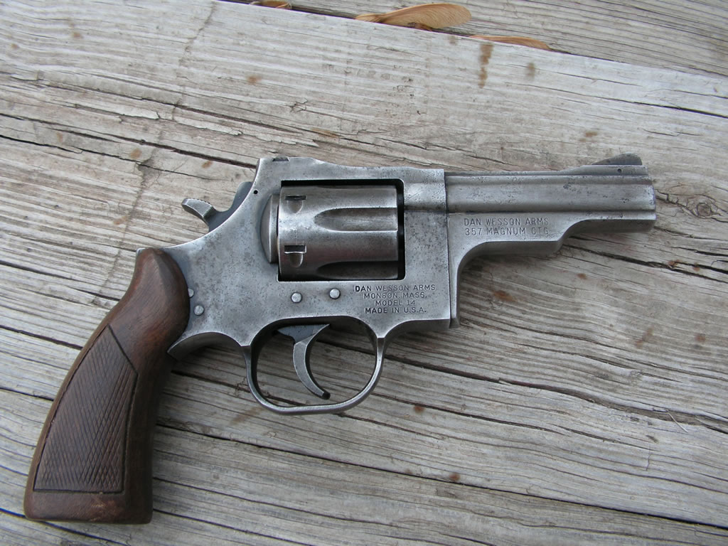

14Image Enlarger
This is a 14, one of my beaters looks bad but shoots great!
