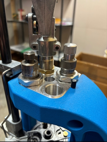

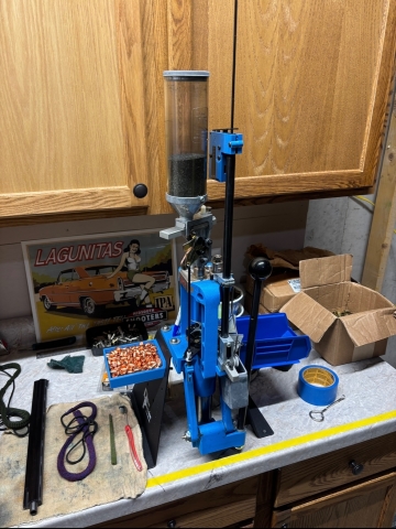

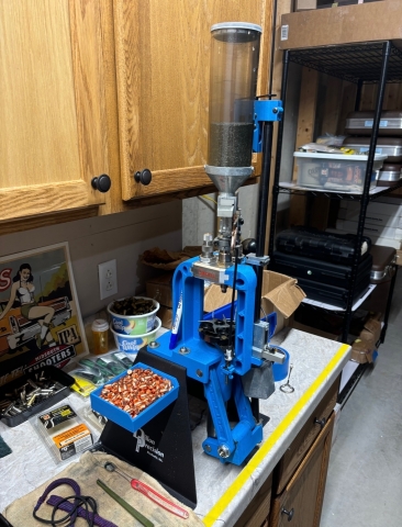

IMG_5309.jpegImage Enlarger
IMG_5308.jpegImage Enlarger
IMG_5307.jpegImage Enlarger
Not sure I understand your question either, but here’s my Dillon RL550 setup for 9mm.

Are those RCBS dies? They look more like lee?

Good question, I’ll look at them closer and see if I can tell.  I bought the whole setup from a good friend a couple years ago.  It was setup for 9mm so I’ve reloaded about 3K rounds 9mm since the purchase.  The purchase also included dies for .357, 45ACP & .445, but I’ve only done 9mm so far.  I’ll have to have my buddy over to show me how to swap to another caliber one of these days.
