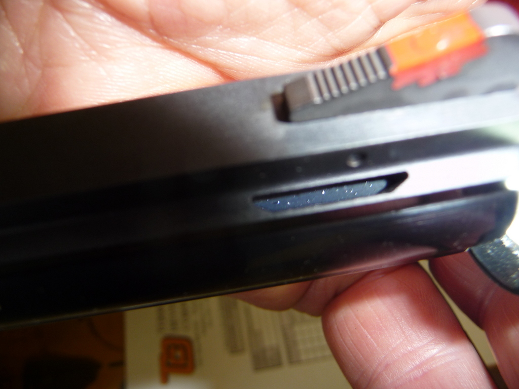

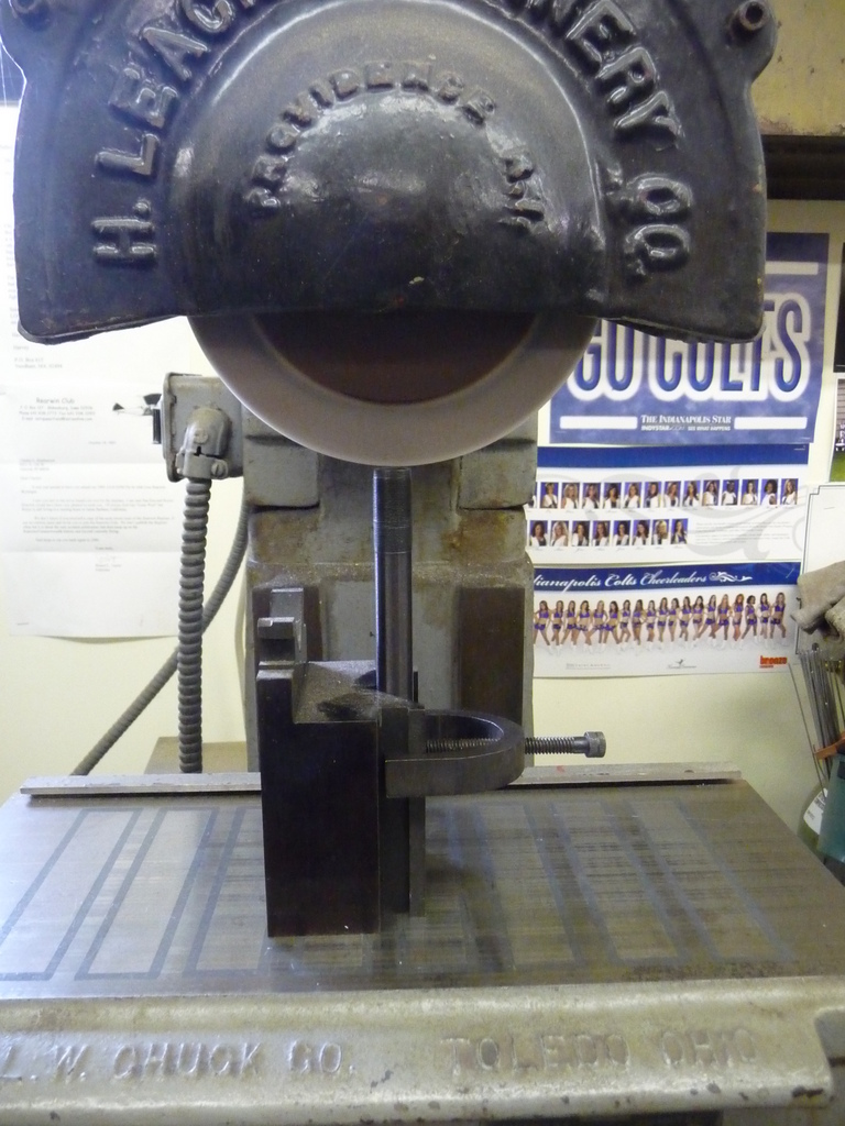

Ok, I'll give this one more try. Jody wants pix uploaded to the site. Tried that last night, and the whole post disappeared into the ether..broken-computer big-grin At any rate, I did some careful measuring and took .012" off the end of the barrel with my ancient surface grinder.
001-1.JPGImage Enlarger
Assembled with a .003 shim between the cylinder and barrel. Lines up nicely if I do say so..

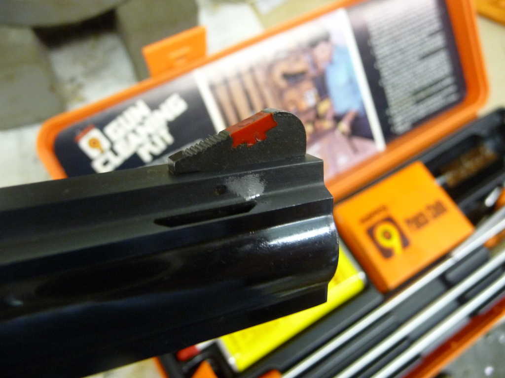

Ok, here it is. There's a little learning curve involved..cool At any rate, this barrel shoots to the left, compared to other barrels I have. (?) I tried light to heavy loads on a cast 140 grain boolit. Once I quit for the day, and started cleaning up the fair amount of powder residue, I see this.. I'm *assuming* it's lead. Doesn't want to wipe off with number 9. I suppose it's trying to tell me that I should use jacketed bullets only? Is this why it shoots left? There are volumes of things I don't know about this kind of stuff...006-3.JPGImage Enlarger

That surface grinder is one serious looking tool!surprised
Chuck in Indiana
Forum Posts: 85
April 28, 2014
August 14, 2014 - 8:36 pm
Like most of my tools, it's an antique. It was an antique when I bought it, but unfortunately, some of my other antique tools, I bought new..big-grin Like my other antique tools, though.. it's perfectly capable of doing "modern" work...wink

I know with the original DW Power Port barrels they recommended jacketed bullets.  I know I had some serious issues removing the shroud from my 44 magnum as a newbie!
