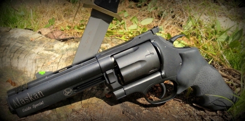

He also stated he's in the market for an Alaskan guide in .445.
This is what he's looking for:
rwsem_AGS_01.JPGImage Enlarger
