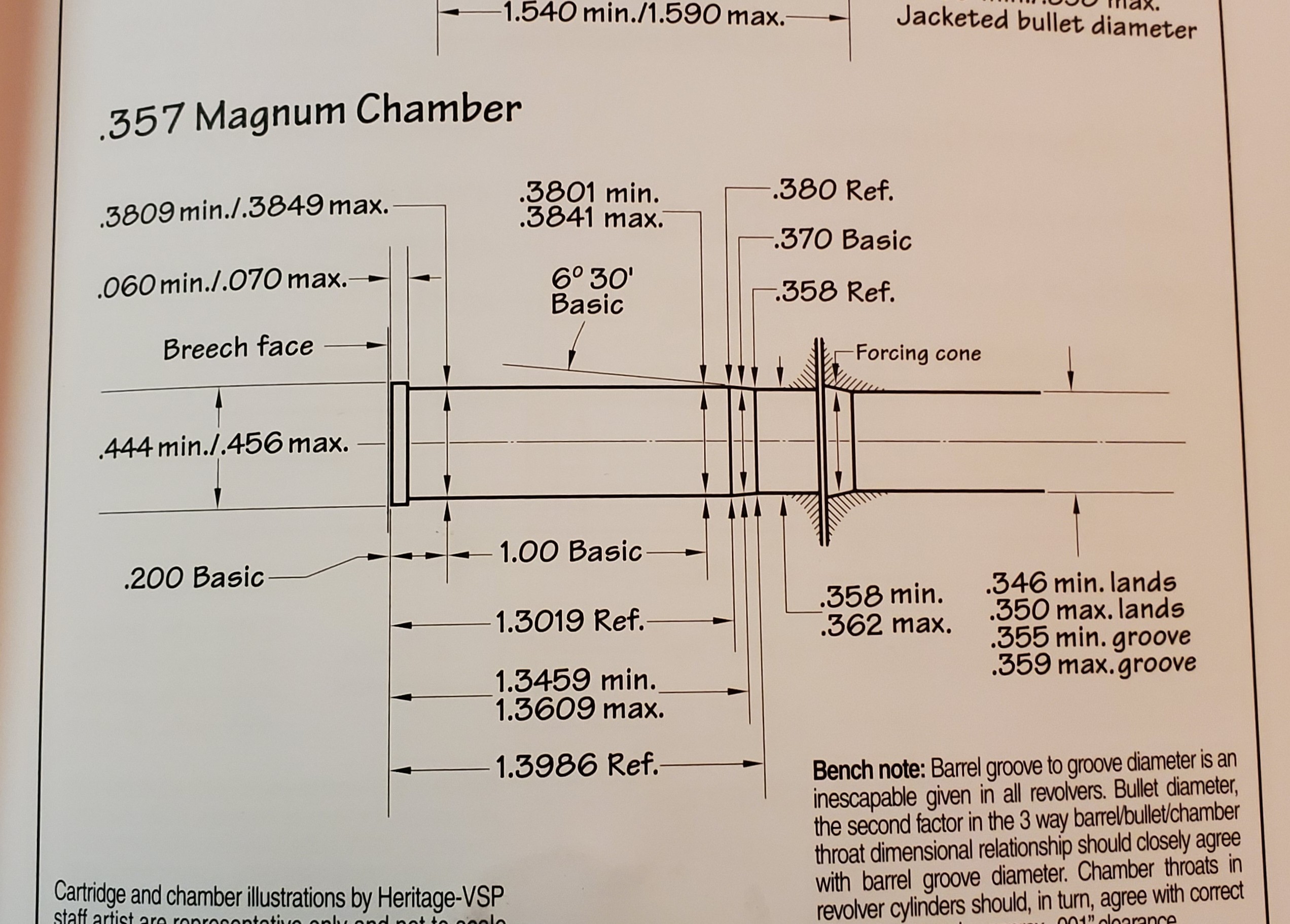

Define oversized. If they are .357-.360 (maybe up to .362) they're probably in tolerance mine are .359 in my Monson and .3585 or so on my Norwich.
superdan
Chippewa Falls, WI
Forum Posts: 403
October 26, 2008
February 28, 2020 - 1:43 pm
20200228_123932.jpgImage Enlarger
Checked with a book .358-.362 is definitely in tolerance.
