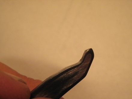

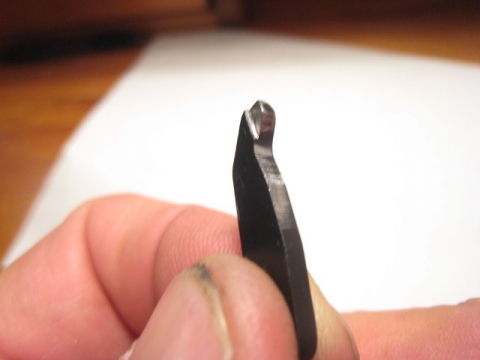

Range trip #2 : After 75 rounds the hammer was not going back either SA or DA without fiddling with the gun. The cylinder locking lug would drop down into the frame but the hammer would stop. With the cylinder open it wasn't a problem so I'm guessing hand/extractor star interaction is the issue? Either the star or hand is my uneducated guess. That brings me to the question concerning the condition of the hand. There is a brand new M15 hand for $20 I saw if this is likely the problem. Do they drop in or have to fitted? What does the condition of the hand look like to you? Edit: it is back to working at the moment.IMG_0280.JPGImage Enlarger

Agree with LB on gap and internal cleaning . The hand is a precise fitted part. It is critical to the timing of the revolver. you might have a broken hand spring. It can cause unpredictable malfunction as you describe.
Forum Posts: 2002
August 31, 2019 - 8:38 am
The hand looks fine.
I agree with others - check gap, then hand spring.
