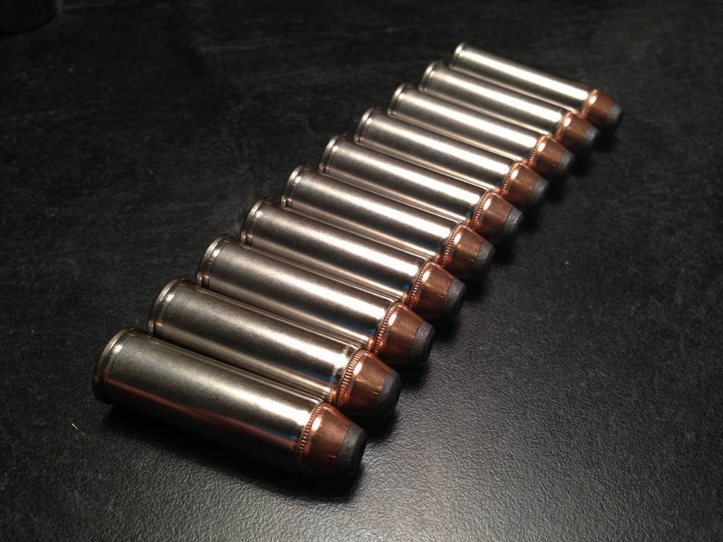

I have finally finished a few reloads. :)  I'm using a Lyman T-mag II press which seemed to do a fine job.
41 Magnum, 170 gr JHC
20 gr IMR 4227
2013-05-17_20_41_25.jpgImage Enlarger
2013-05-17_20_41_34.jpgImage Enlarger

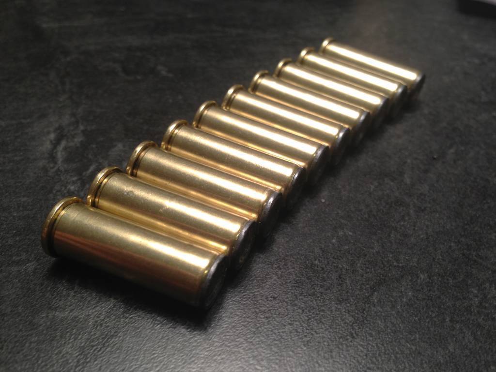

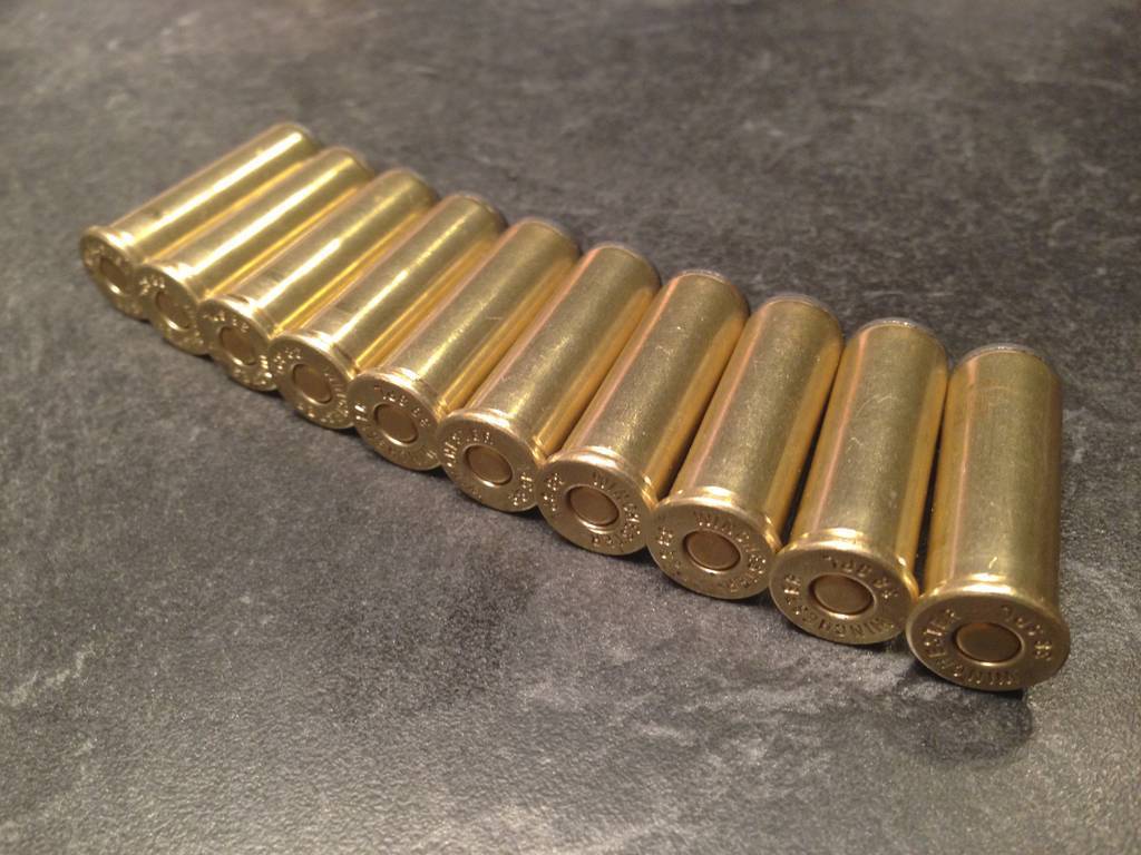

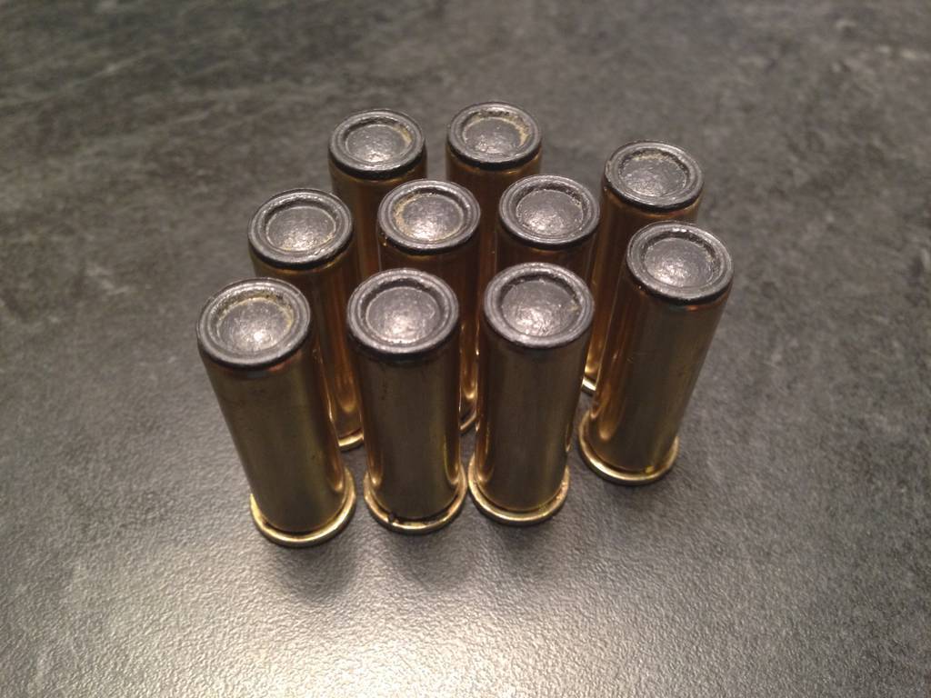

38 Special, 148 gr HBWC
3 gr Bullseye
2013-05-17_20_43_05.jpgImage Enlarger
2013-05-17_20_43_14.jpgImage Enlarger
2013-05-17_20_44_06.jpgImage Enlarger

Looking good- should work just fine. IMO, the 41 has about the right amount of crimp and you could lighten up a bit on the 38s.  Hard to tell from your pics but the primers may be seated a bit too deep. It could just be the angle and lighting etc... All you can do is try them to find out.  Watch for pressure signs while shooting and let us know how things turn out!

I loaded the 38's first and learned a few lessons with them. I agree that the crimps are a bit too much. While loading the 41's I realized how to adjust the crimp, so I'll go back to the 38's and try again. I'm not loading very many rounds until I'm happy with how they shoot. Thanks for the tips.
