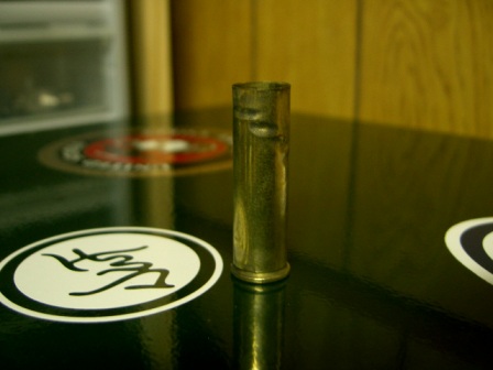

Maybe an add on to our reloading bench pics would be our "oops pile" pics?.  I did a neat one recently that perfectly folded the neck all the way down to the bottom of the bullet but only on one side.
6point8
northeast pa
Forum Posts: 157
January 17, 2010
27
March 18, 2010 - 1:01 am
one side of 357
other side.  felt a little tough on the press, just thought it was crud.
case from starline that bent my primer pin....no flash hole, and a neat bump on the inside where it should be.
A wrinkly case from those darn 430's.....if fit in cylinder so i shot it hoping to straighten it out, guess not.
reloading is fun, and sucks sometimes too....  I am always learning and even trying to remember what I thought I learned too.  We get reminders of lessons here and there, ha ha.

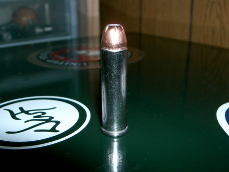

I was finally able to get out & shoot my reloads yesterday!Laugh I ran the .44's through my Super Blackhawk…mainly just in case one of 'em blew up, I didn't want to ruin my DW.rofl Besides, it's a tough gun & I like to shoot it.
Every one of them went bang & none of them seemed to have any pressure problems, it was great! I honestly expected problems, so I'm really happy that they performed well. I even got one of the wrinkled ones to chamber, and…BANG!Laugh

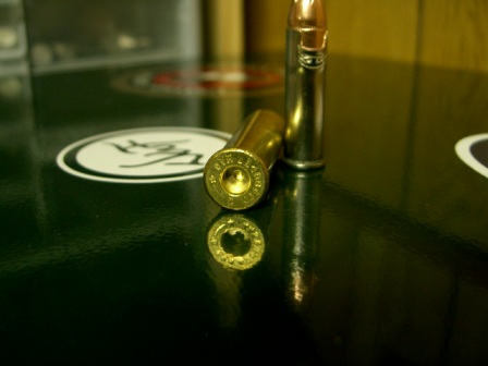

Now the .357's were a whole 'nuther matter.Confused I chose my newly acquired 15-1 Porkchop to be the guinea pig. 'Chops usually have rough chambers & I found out yesterday that if you're having pressure issues, a rough chamber isn't the best to use.rofl I had pressure problems in about 45-50% of the rounds…had to use a stick for extraction on most of them.Embarassed Two of them had a FTF on the first pass…had to take another whack at them to fire.
Here's a few of the worst offenders, with a good one on the left.
Same group here, with the flash off…
3 or 4 pushed the primers just enough to require an assist when cocking the gun, otherwise they just pushed the firing pin punch back out almost flush. All of these have the cylinder grooves pushed into the brass…I can feel them with a fingernail.
I'm not sure if I crimped too tightly, or if my powder measure wasn't exactly even on these. I used Unique in these (H110 in the .44's) & being a fatter, more flaky powder, maybe it didn't measure as uniformly in my powder dispenser. I checked the powder dispense periodocally & it seemed to be within a grain or two of each other.
The dispenser I'm using is a used one & it does leak a bit of powder from the pivot shaft with each cycle…I have a catch bucket below it to collect the leak.Confused  So it's ability to accurately measure a load is in question. It's probably got a worn o-ring, or something…I should probably just buy a new one & save myself some grief.Embarassed
30
March 21, 2010 - 12:09 pm
You've got some primer "flow", but they are not flattened out... I'd say it was the crimps, but only you will truly figure it out.
 Where is your PM leaking?  I buy all my PM's used and have never had any kind of leak.  I remember you buying it, but I don't remember what it was.  Don't buy another one, I'll sell you one of mine if yours is truly bad.
Forum Posts: 11284
31
March 21, 2010 - 12:20 pm
It leaks out the side, between the body housing & the handle…pretty annoying. I thought I'd take it apart & see if it's got an o-ring I can replace. If you want to sell me one of yours though, I'll let ya.Big Grin Even if I do fix this one, I can use it to just dispense H110…just 'cuz it seems to like that powder.
I'll try less crimp on the next batch & see if that goes better.
