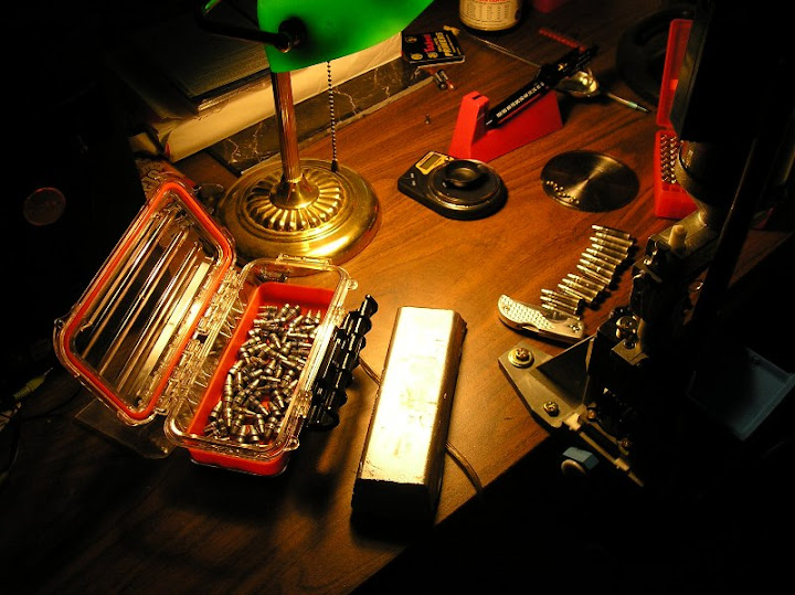

Not sure where to start? I do not have a fancy work bench but here is the guts of the operation:
That picture is too dark.. but it shows a 10# lead bar in front of the box of home cast bullets.

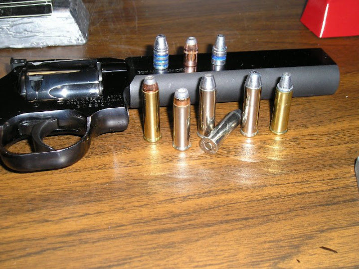

Not a bad pic of my EWK shrouded 15-2 with from left to right:
180gr cast flat nose SWC
Nosler 158gr JHP
148gr cast (small cone) SWC
The three rounds on the table are the 180gr .357 being motivated by 13.1gr of LilGun.
Same shot lower angle. Note the Lead bar.. now a paper weight and a few boxes of primers.
And again but with even more variety.
Left most Nosler 158gr on top of a .357 with 17gr LilGun (max is 18gr)
Next is .38+p with same bullet.. 3.8gr TiteGroup
Last is the 148gr in the .38 +p on top of 3.4 gr TiteGroup.
