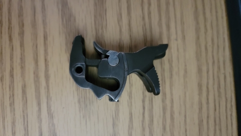

Jumping from trigger to hammer....(It's "Hammertime!"), I was told the the hammer in the pic below is from a 44 mag?
It is a small frame Model 8-2.  So, now I am confused.
Add to the the different types of hammers.   Can someone tell me to purpose of the drop-tab on the lower arm, on the Right one below?
And lastly, is there a link on doing a "trigger Job"?  I would like it to squeeze like butter, and maybe a lighter trigger, but not a "hair trigger".
Thanks
Forum Posts: 4286
July 20, 2024 - 4:22 pm
I can't see the "Drop Tab" in that little picture. I have no idea what a drop tab is. The hammer on the right is an early small frame hammer with the shorter hammer tang. The one on the left has a later, longer one. Your bobbed hammer will perform in DA only unless you can somehow cock it. Any small frame hammer will fit. It is not a 44 mag hammer. You need to stop listening to sellers. They are mostly ignorant. My dear deceased FFL buddy told me never educate sellers. In this case, the seller was totally ignorant. I hope you got a deal. There is a gun parts kit on Gunbroker that has a hammer you can use. Or look on eBay. Or I can send you one.

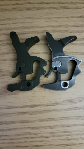

20240720_122946-Snagit-V1.jpgImage Enlarger
This the full size photo... The hammer on the right I have recorded as a large frame version and the left is the small frame version.
the shape of the area circled in red is the question....

snake-eye said
Both are small frame hammers! Not large frame.
Good to know... Thanks. Given their size I was suspicious of the label on the ".44" hammer.
As to the difference in shape of the sears, any thoughts on why?? One a 15 and the other a 15.2??
Also the thumb is much longer on the ".44" edition... same issue??
I have 2 of the small frame hammers and 5 of the labeled ".44" hammers... would like to get the correct model label on all of them.
Forum Posts: 4286
July 21, 2024 - 1:43 pm
They are both small frame hammers. What you call a drop tab has no function. The one on the left is from pre 1975. The right is the replacement. The hammer was reduced in size and the tang lengthened and slimmed. The reduced hammer face changes nothing. It just strikes the transfer bar. Rwsem  and Snake-eye are trying to tell you what I have been saying. Neither hammer is large frame and they are interchangable. The differences are minor and inconsequential.
Great. Thanks... the ".44" was labeled that way when I got the parts bin 20 years ago and I do not have any detail knowledge of the fine differences. I have updated the label for the ".44" to the correct label.
I understood from Rwsem and Snake-eye that they were both small frame.

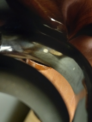

When the overtravel screw gets too far into the trigger (out of adjustment) on two of my 15-2s the trigger makes contact with the trigger guard and gets wedged into the guard and fails to return. Less than two threads showing is about where it becomes a problem. You can clearly see the contact points where the blue has worn. So at least on my guns it's necessary to function properly.20240724_082349.jpgImage Enlarger

I mentioned in post #13 (replying to you) the screws are on the back side of triggers. Snake-eye said he didn't think the over travel screws effected the function of the revolver. My post #16 was explaining to Snake it does effect function.
July 24, 2024 - 8:14 pm
I’m curious what’s going on here, I hope you figure out why the overtravel causes the trigger to hang up at full pull/travel.  When it happens, what do you do to get it unstuck?
stonebuster
Forum Posts: 301
August 20, 2019
July 25, 2024 - 12:00 pm
Pretty simple really. If the set screw on the back of trigger isn't sticking out far enough the trigger wedges itself into the trigger guard making contact as shown in photos. The trigger pops back out with a little help. As long as there's a couple screw threads showing outside the rear of the trigger it returns just fine. The problem was when shooting the overtravel screw would gradually screw deeper into the trigger an eventually allow the trigger to make contact with the trigger guard again. A drop of blue lock tite on the screw corrected it. No more problem now.
