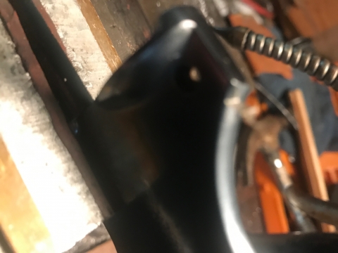

Hello, I have acquired a couple model 15 parts. Interesting that I got a decent deal, due to the parts being capital U Ugly! Looked scratched, dented and neglected, but, No detectable rust/pitting. My question is, was there some kind of clear coat applied at the Factory, ever??? This seems to have a clear coating on the various parts. I will try to get a Picture, certainly if I find that I can clean some of this up a bit!!
Thanks for taking the Time.
Edit for pictures, best I can do sorry.
Pic one shows what appears to be a Blemish, but in pic2, you can maybe if ya Squint, see it is a coating that I removed with my Thumbnail as seen in pic 3.

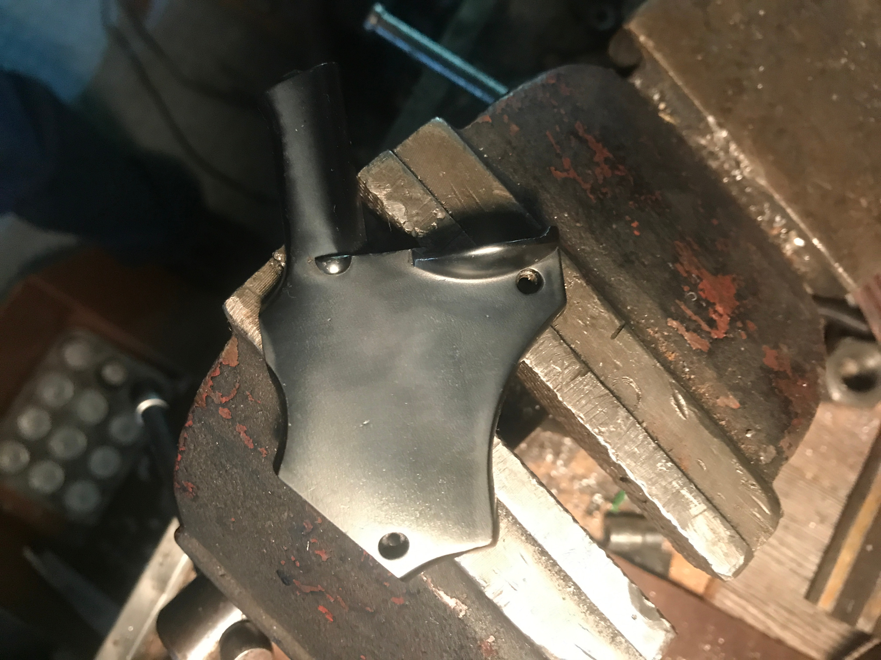

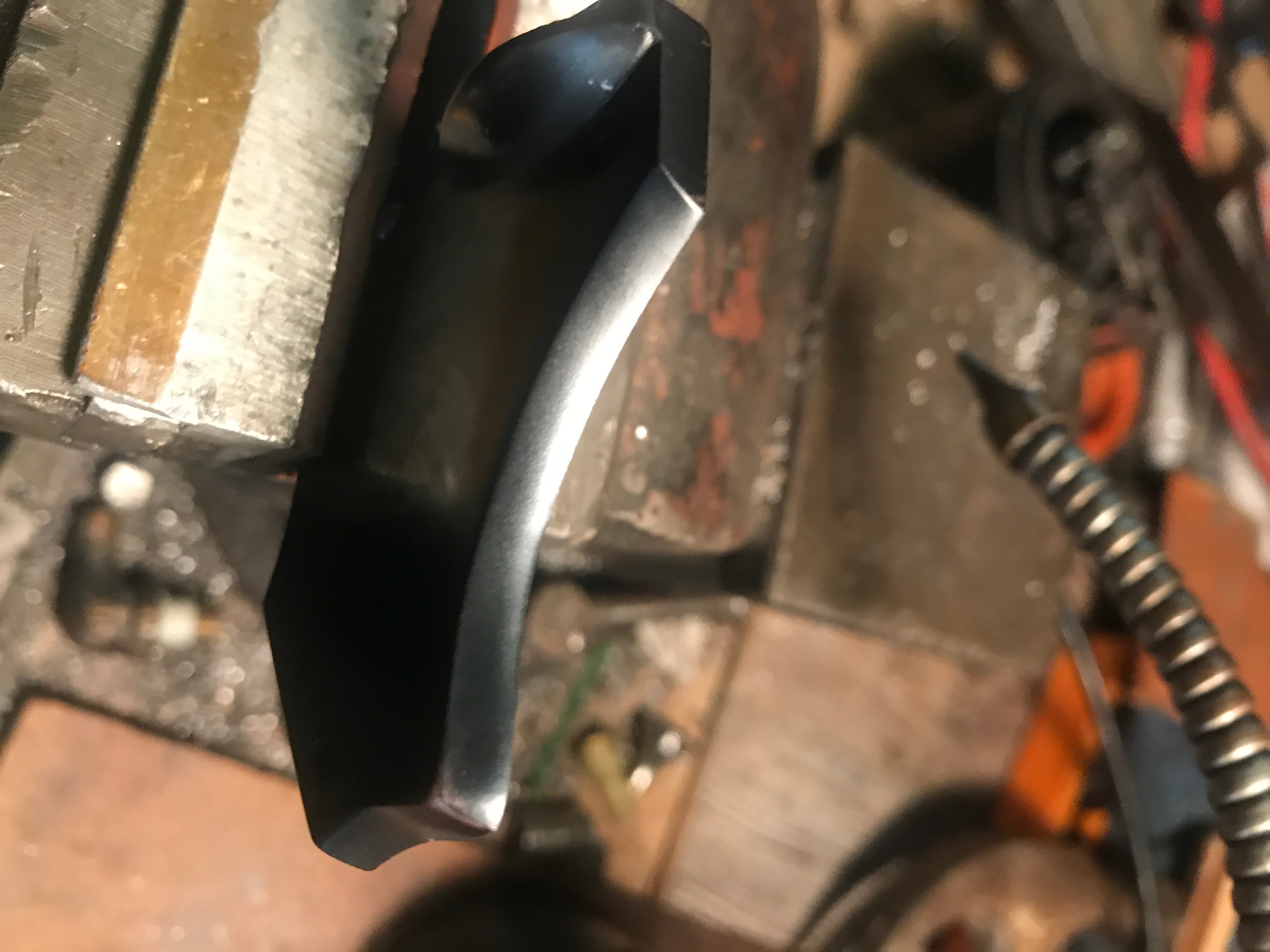

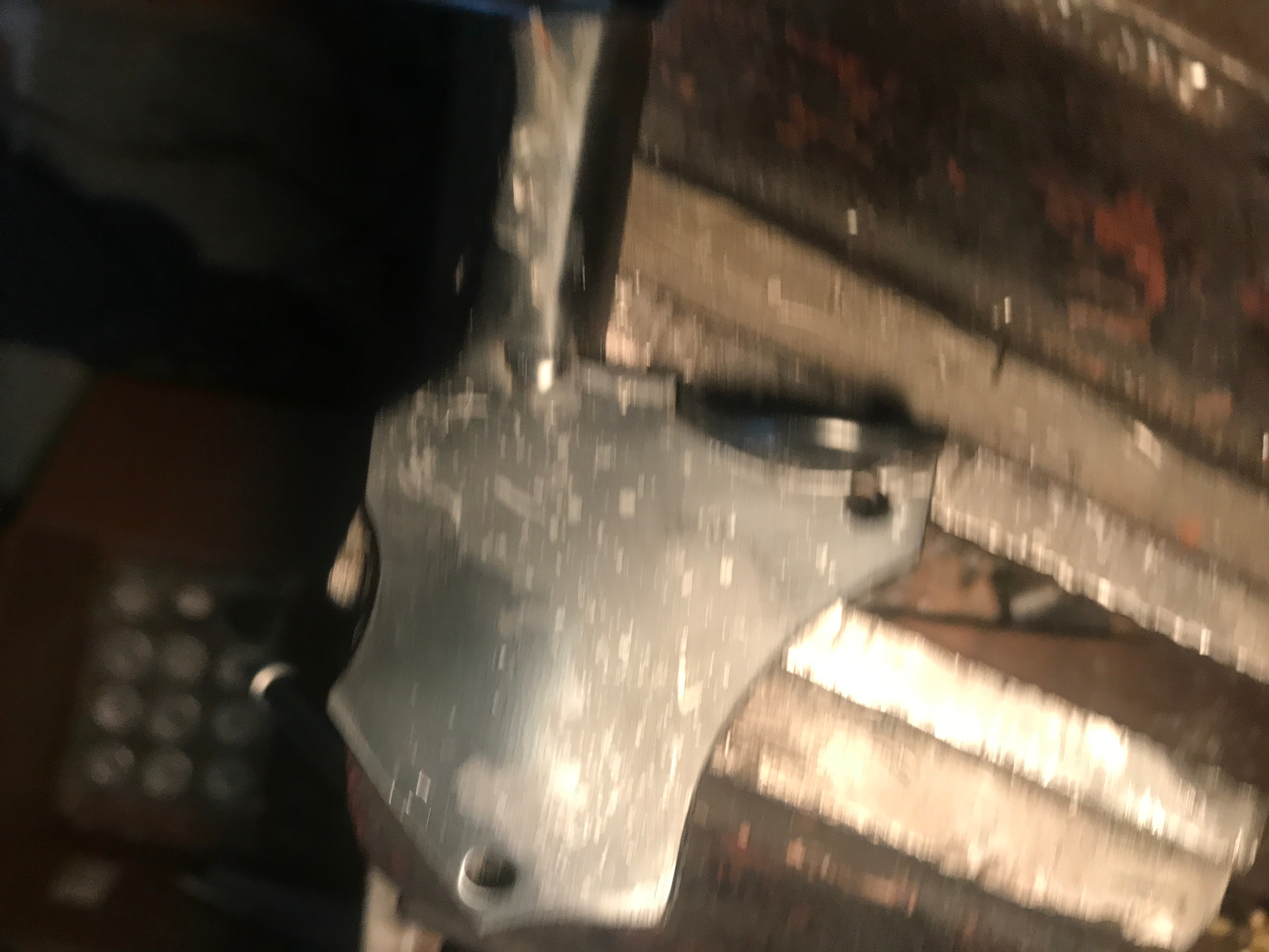

IMG_1622.JPGImage Enlarger
The side plate I started with
IMG_1626.JPGImage Enlarger
The spot that looks like a Blemish
IMG_1627.JPGImage Enlarger
Trying to show the "coating" peeling up
IMG_1629.JPGImage Enlarger
Right after I peeled it on off with my Thumbnail!!!

Maybe someone had it Duracoated...It Aint Now... The Sideplate cleaned up to look better than the one on my 15-2IMG_1623.JPGImage Enlarger
I think it looks pretty good
IMG_1622-1.JPGImage Enlarger
Compared to the utter Mess it started as...even with Crappy Picture...it look Bad!!!

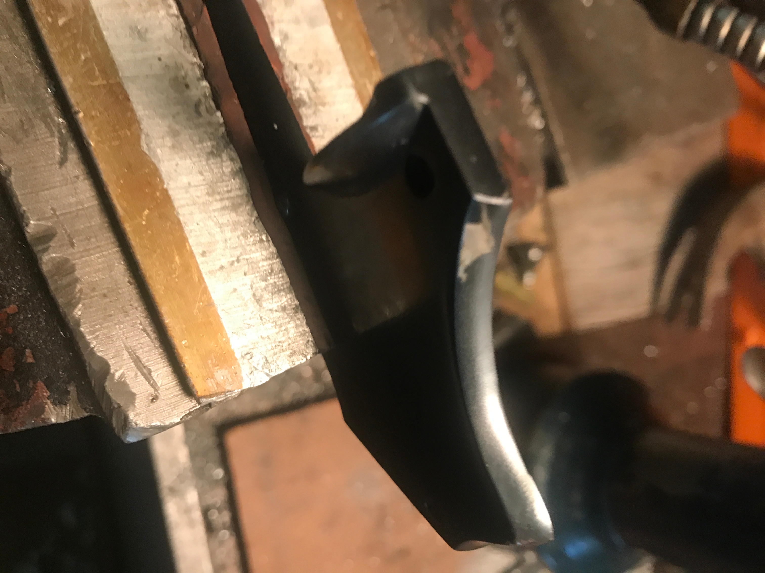

May 8, 2024 - 10:06 am

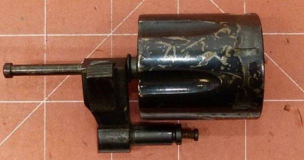

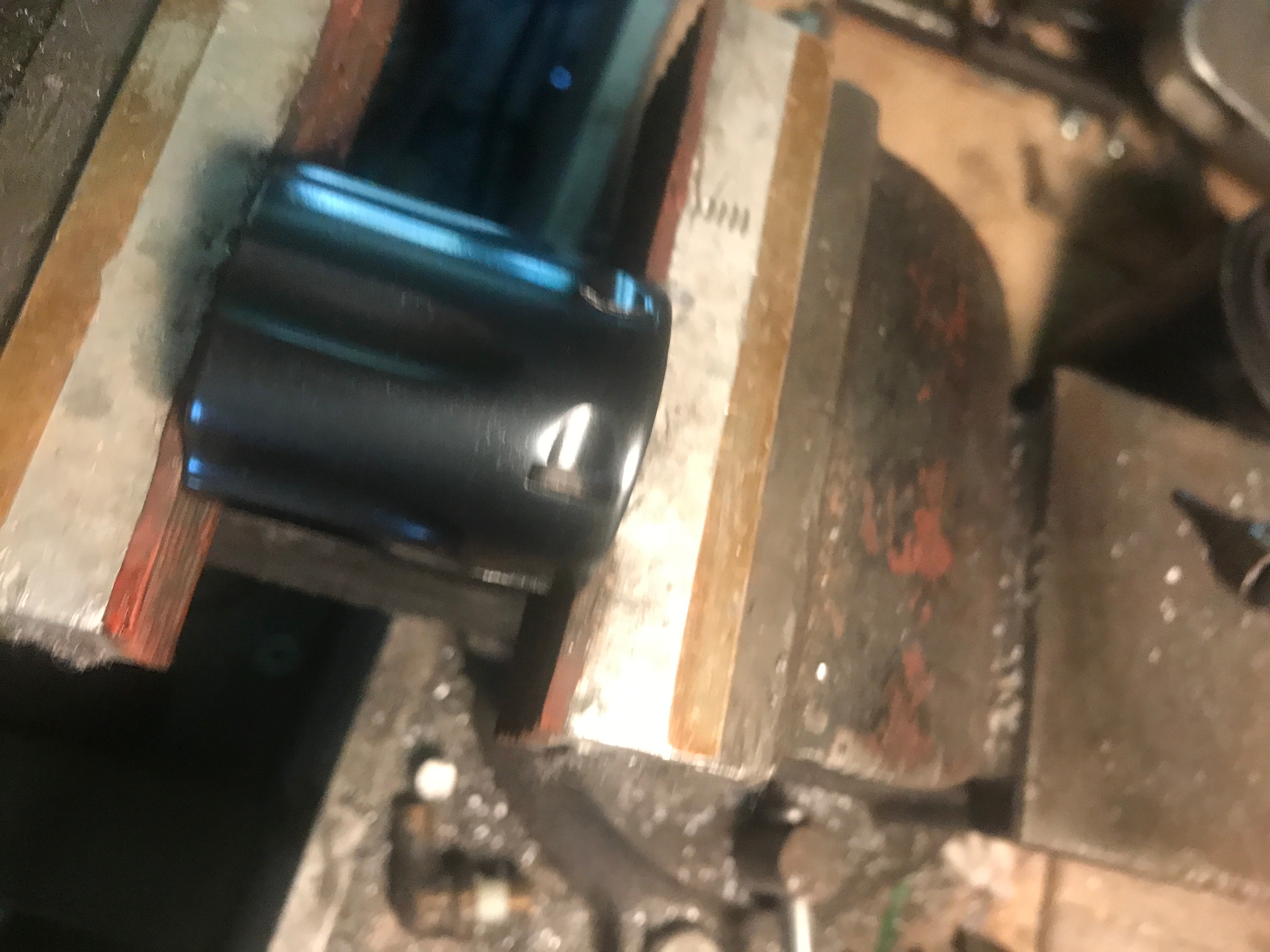

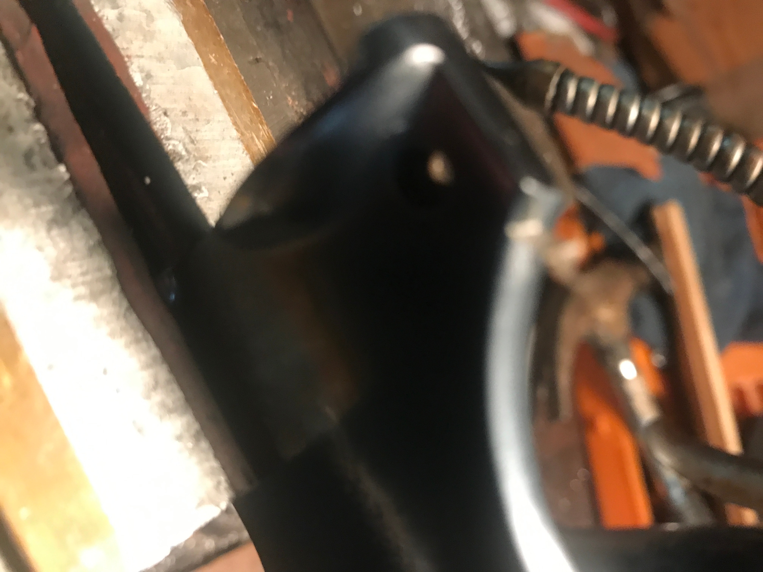

@rwsem   Apologies for poor photography skill, or lack of Skills.
The blue is quite nice under the "coating" Which I would certainly think was Not Factory!
It did a decent job of protecting the darn original Blue, to the point there was hardly a Turn Line under the stuff on the Cylinder, Which looked originally like a Lost Cause!
dwcyl-2.jpgImage Enlarger
Edit to show cleaned up cyl
IMG_1631.JPGImage Enlarger
Good thing I learned about posting Pics huh?? Hope they gots plenty of Bandwidth here!!

How do you peel it off?  Just by using a fingernail?  Or something more aggressive like 0000 super fine steel wool?
racepres
Forum Posts: 121
May 6, 2024
May 8, 2024 - 10:13 am
Oh...being lazy, I use Both...the 0000 wool mostly does the trick...some spots need fingernail...but, I'm fast running out of Fingernails!!!!
Ed's Red soaked into steel wool..
Edit; to Note, I rarely use "naked" steel wool, except on stubborn or flakey Rust. Learned from milsurps. Eds Red pretty much avoids "scratching", If Quality Steel Wool, true 0000, is used! Well Soaked = Messy!!!
